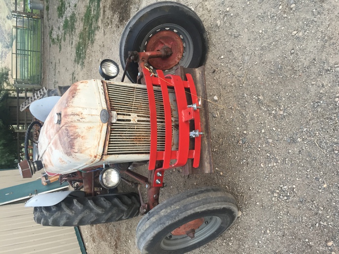

Good morning, people.
I just had the generator rebuilt on my 2N, and she's charging great. I'm giving it the pre-summer once over, and I got to thinking about lights.
Mine has no lights whatsoever. Nothing. No housings on the front, no wiring. Absolutely nothing. There is an old switch in the dashboard (which is no good) with the wires all cut.
First of all, I really am not worried about looking authentic. I'm looking for rugged, bright, ease of installation and useful.
There must be some good choices now, with the advent of LED lights.
By the way, mine is running the 6V system, positive ground, just like it was originally made.
Has anybody retrofit their 6 Volt 2N with lights that they would recommend?

There are Lots of options for 12V LEDS
which will light up your way at night
almost like it's daytime and they use a
fourth? of the wattage an incandescent
light does.
But a couple minutes of searching didn't
turn up much for 6V LEDs.
I guess I would look for some good old
Tract O Lights which were used on Fords
for about 40 years and put those on.
Someone here will know the bulb number
you need.
Heres some on ebay both new and used.

I've yet to find any good options for 6V LED headlights. I was in the same boat as you, my 9N had no headlights so I bought Tract-O-Lites from Dennis Carpenter along with a Taurus taillight. I also added an 8N worklight (the worklight wasn't an option on 9N's and 2N's). The additional current from the 8N incandescent worklight was too much for the 9N 6V generator so I was able to find a nice LED Par36 bulb for the worklight. It only draws .95A at 7V and is nice and bright. It's also a drop in replacement and looks close to the original bulb unlike some of the LED bulbs out there that simply look strange in an old tractor, this is the bulb - https://www.amazon.com/gp/product/B07LBKCRSR/ref=ppx_yo_dt_b_asin_title_o08_s00?ie=UTF8&psc=1
In my case since I'm running a snowblower on my 9N all winter I actually prefer the incandescent bulbs because they run hot enough that the snow won't build up on them. I snowblow my driveway and the private road I live on, there are no street lights but the 6 volt 30W 4019 incandescent bulbs I'm using are plenty bright enough for my needs.

Stiener (sic) has a good assortment of housings and 6V bayonet mount LED bulbs but I can't link to them here. I am sure there are lots of other sources.

I happen to have a 9N that someone put lights on before I bought it, so it was many years ago. I am still using 6 volts with the original type 3-brush generator. I figured out what kind of headlights I have when I was visiting my uncle. He has a Ferguson TO-20, and my headlights are exactly like his. Mine were installed nicely, including the Ford wing-shaped base on side of dogleg. (No one at a tractor show has ever mentioned that my headlights were not original to my tractor!). Just me talking....

The ACS152 light assembly with the ABC3857 LED bulb might do the trick.
With the LED bulbs, the generator should be able to power two headlights and a work light facing rearward. I also want to mount a switch on the fender to switch between the rear work light and a red safety light for road travel.

Here's an 8N style worklight, they have a switch built into them:
