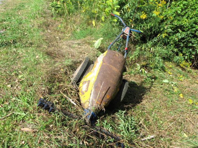

I have a couple of those walk behinds. Brand Jari.
Trouble is high weeds like to jam up on the body.
I have to stop and remove them or carry a stick in one hand to try and dislodge them.
I know of very few small tractors with sickle bar attachments.

If you look at the picture closely, you will see a 1/4" rod about 14" long sticking up in front of the hood....it moves back and forth with the cut bar and sorta "parts the way" so weeds don't jam up on the hood. Works really well.....However, when you cut a lot of big weeds and small brush, that rod will sometimes break off.
Seems like I have to replace mine at least once a season.
I will tell you this.....Those Jaris are tough machines and built to last forever even though they are sorta crude.

No wonder mine jams up, the rod at the most is 9" long and bends over from the weeds. It's soft metal and broke off several times.
I think the original must be tempered to keep it from bending.

I found some hardened 1/4" rod that I use....it doesn't bend very much but breaks off clean when it goes.
I think the rod I got came from the torsion springs used in the older cars to keep the trunk lid up.
I've always thought of drilling the bracket out to 5/16".....I think the bigger rod would last a lot longer.

My thoughts exactly. I also thought that a fixed "V" shaped rod extending about a foot past the bar might separate the weeds enough to solve the problem. But that probably would only work if the weeds were standing straight up.
