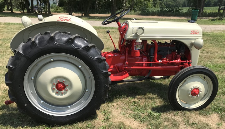

Hi Everybody,
It seems your hobby/passion has attracted one more nut - like a moth to a flame......ME. My wife and I live in NJ and are looking to BREAK BAD (without the meth production) and move to north-central Arkansas. We're looking to pick up 18-20 acres and to build our last home on it. We're in our late 40's and the clock is ticking - plus Jersey is just killing us with taxes. So - while watching a youtube video, I saw a homesteader who had a 9N and swore how it was his go-to machine for everyday work. And he mentioned sites like this one for parts and support. Well, ya know - I HAD to go get one for the wife and I.
So, I went out a picked up a '39 9N off of Facebook marketplace. It was a 2 hour drive but it was what I expected - non-running, well rigged over the years....tires and rims shot but block looks clean - no cracks or repairs visible. Figured I'd rebuild the whole animal.
Fast forward 2 months and the block is being boiled and trued up now - and I've decided to restore - not just repair what has become a member of our family. The guy I bought it from said "It's addictive" as I was pulling out of his driveway.....He wasn't kidding.
Thanks to awesome folks like y'all as well as sites like this, aside from going broke Laughing I've got my part list built out for just about everything. I'm about to place an order that should help keep YesterdaysTractor online for long while.
Anyway, one thing I have NOT been able to find - A piston sleeve removal tool. I've heard about ones made by someone here (Oldskoakie I think) and have seen videos with them being used so perfectly. I did my due diligence checking the forums here but couldn't find anything about them. Does anyone know if they are still available or a place I can buy them new or used? I heard they are "bouncing around the country" in finely made wooden boxes from one enthusiast to another. Smile If someone could let me know how to get one bounced my way, I would GREATLY appreciate it. Also, I'm new so - if I can help in any way, also, lemme know.
Thanks again - sorry for the long post.

Hi BigBry, welcome to our world. It sounds like you've done a lot of research so far. As for the sleeve puller, here is my suggestion. Unless you are planning on restoring more tractors in the future, I would search around your area for a machine shop that knows what they are doing, already have the tools and have them put new sleeves in. Does your '39 have the aluminum hood etc.?

Sleeve Tools Here

The snap-in hood is correct for a 1939. Is the rest of it '39?
You can use John Smith's wealth of knowledge now stored here
to decide the identity for yourself. Might make it worth putting more,
or less money into depending on what you actually have.
In the end, unfortunately, you're not likely to get your money back
on resale but you may get it back time and time again on use! Smile
BTW, that set of tools that was floating around the country in the
wooden box is currently in my garage being well taken care of.
Email me through YT if you'd like to discuss using them.

I would have the machine shop grind the valves and seats while he has it... If the valve guides, valves and lifters have not been updated now is the time to do it...
Original guides would be two piece, valves would have a tulip end and the lifters non adjustable.
Updated would be one piece solid guides, conventional valve tips lifters adjustable (have a adjusting bolt where the vales rides on it)
The original valve springs are different I would have to think on the difference maybe someone will fill ya in on it...
Lets see if this will work
http://www.8nacres.com/1939_9N/
You will have to click on restoring then scan across the pix till you see his comment on the valve springs...
Next you will need to check piston to head interference this becomes a issue if you deck the block...
Their is some differences in these old flatheads its not yer dads Oldsmobile ask questions if you are unsure...

If the sleeves are still .040 the shop would bore out the old sleeves to the size to insert the .090 cast iron sleeves.

I have a sleeve tool I would loan you. Pay a refundable deposit and shipping both ways. Send email if interested.
