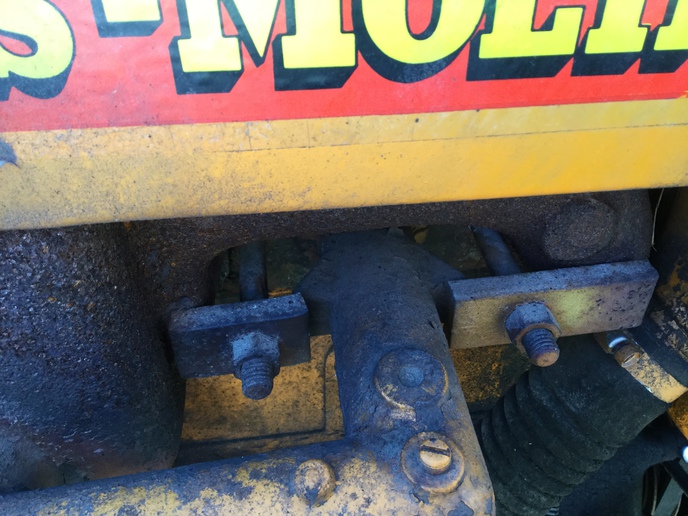

My '53 UB has huge cracks in the exhaust manifold. Didn't help when I created huge backfires when I went to new Pertronix, dist. cap, wires, plugs, then reconnecting the wires incorrectly. Didn't realize that the rotor moves counter-clockwise. Anyway, I have ordered a replacement exhaust manifold and want to know if anyone has done this and if they can offer any advice. Thanks.

Thank you for the reply. What kind of paint did you use? Also, did you have any issues removing the [rusted] nuts? Looks like they are originals. Here are some photos.

No, the nuts came off pretty easily. I usually replace them, and the studs if they are worn. That thing is really cracked! I used high temp primer and
paint and it didn?t work well. I have been having the ones I have done lately cerekoted.

Replaced a cracked manifold on my '47 UTU (same engine as your UB).
Had no issues whatsoever changing it out. The clamp nuts (brass) came off easily, and the new manifold fit up perfectly.
I didn't bother painting the new manifold. It came painted, and the original manifold lasted 60+ years with the OEM paint - that's good enough for me.
Back to top

Usually if nuts don't want to turn:
the stud will screw out. Yours don't
look too bad. Should be an easy swap
