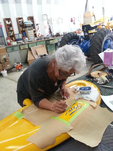

Well I am not a painter by any stretch of the imagination, blind in one eye and the good one is going south. I have compressors and paint guns but I wanted to try this HVLP a few years back
for different small projects . I brought this Fuji with all the different needles for different thickness of paint, everything from lacquer to latex. So when I was rebuilding this tractor I thought I would try this gun and all things considered it turned out ok for a work tractor. I had the Wife paint the scripts,I figure if she can do Nails for women without getting polish all over their fingers she could do this.
I shake like an old dog crapin peach pits.
