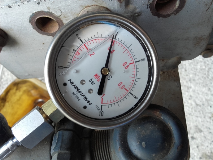

Here the problem: it breathes a lot from valve cover breathing hose, from dipstick and from oil filler cap. Here s the video. I do also find drops of oil on the floor after she is shut down.
This is the only issue so far- at least the only one noticeable. I am aware this could be due to worn bore /sleeves / worn valves so I decide to do diagnosis myself also thank to youtube video on this Perkins motor (Bundybearshed and cheaphomesteading channels did really help, great guys).
Got cheap ebay tool for compression testing the engine, these are the readings I got.
Cyl#1 (radiator side) 290/300 psi tried to squirt some oil in and it peaked up to 420psi It
Cyl #2 370/380 psi (no oil squirt test here) I know 400 psi is the desired value
Cyl #3 - 370/380 psi(no oil squirt test here
As cyl 2 and 3 seemed good compression I did not made the oil test. I suspect cyl #1 is down. To me, as long as cyls2/3 are not bad this in now and overall wear, I may suspect stuck rings oin cyl 1 only. Your comments are welcome.
I took off also the valve cover and breathing does not come from valve but from passages in the head heading down to pan.
Thermostat does work indeed, gauge stays at half of the scale, green area. Oil pressure is around 3,5/4bar (50/55 psi) both hot and cold at 1000 rpm.
Oil level is not raising and does not look milky so neither diesel nor water are leaking from head to block. The exhaust does not smoke at all when warmed up.

If your engine has good oil pressure a in frame rebuild will be good. If you have low oil pressure also then the engine needs to come out so you can do all the main bearings (and or turn the crank if it's worn). On my 135 the number one cylinder has bad rings, and is low on oil pressure also so mine needs to come out.

the pressure is those you see in the gauge not at idle but I'd say around 1000/1500 rpm...

With the engine operating running at normal operating temperature....Thermostat stat works?......175 F >180 F + ...Engine RPM at min
speed....
Loosen off # 1 fuel injector Line and take note (visually)of amount of engine blow by from Engine OIL filler tube.....
Tighten # 1 line back up and
Loosen off # 2 fuel injector Line and take note (visually)of amount of engine blow by from Engine OIL filler tube.....
Tighten # 2 line back up and
Loosen off # 3 fuel injector Line and take note(visually) of amount of engine blow by from Engine OIL filler tube.....
Tighten # 3 line back up and
Was there any obvious (visually) difference in the amount of engine blow by from Engine OIL filler tube between any of the cylinders when
fuel lines were loosened off..????
I have seen large scaled Monometers on 4000 >10,000 HP Piston Engines monitoring Crankcase pressure...
Bob....North Western Alberta Canada...

i gave a try to do what you suggested by disconnecting the injector lines one by one and I did not notice any great reduction of blow by and most for, oil filler cap envy if I was under the impression when disconnecting the injector on cylinder #1 the sound of the engine did not change noticeably while it did when disconnecting others.
So I am quite lost here The blow by is huge and when engine on at min rpm if I pull out the dipstick I got oil spits everywhere due to pressure blow by..
