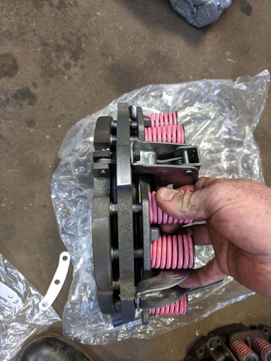

Hi all,
A while back I asked about a new 2-stage 5-speed clutch kit I got for my Ford 861. I noticed the clutch disc has dampening springs on it, while the new one didn't appear to. Showcrop asked for pics so here are a few of the old and the new clutch. Is it a bad idea to be without those springs, or am I worrying for nothing. Or is this just a different design accomplishing the same thing? Another thought: maybe there are dampeners on the new disc that are just not visible from this side of the disc (and could the old disc be installed backwards?).
If it would be worth doing, I would consider getting just the disc from New Holland (assuming it has the springs) and replace the disc on the new clutch pack that doesn't have the springs. If that is an involved procedure requiring adjustments, etc. with special tools, then I would might skip it. Any thoughts appreciated.

Damper springs are meant to smooth out torsional engine vibrations. While they do a pretty good job in
accomplishing this task, they can and do fail after high hours of use, as the springs usually end up beating
out the pockets where the springs ride. Once that happens, they fall out and jam up the clutch to the point
where it won't release.
Unless you're using this tractor hard all day every day, I wouldn't worry too much about the lack of
torsional vibration reduction. It's nice to have, but not an absolute necessity.

PostPosted: Tue Jul 16, 2019 3:08 pm    Post subject: Re: Ford 861 clutch pics old vs new question Reply to specific post Reply with quote
Thank you Bern.
I would use the tractor hard periodically. Maybe it would be more important if I were running a baler.
It would be nice to have to help reduce vibration or wear in the gearbox, but I guess the makers of the clutch kit saved a few bucks by using a disc without the dampeners. Wish I knew more about this in advance. Learned something! Thanks

PostPosted: Wed Sep 11, 2019 9:20 pm    Post subject: Re: Ford 861 clutch pics old vs new question Reply to specific post Reply with quote
Hello Blair , Been a few years since I spoke with you . Looks like you doing the diesel over again ? To add to what Bern told you about the clutch dampening springs , your old clutch is a standard duty Ford clutch with the three dampening springs they also made a heavy duty unit with six dampening springs as you can see three empty holes on your disc . Thanks Tony
