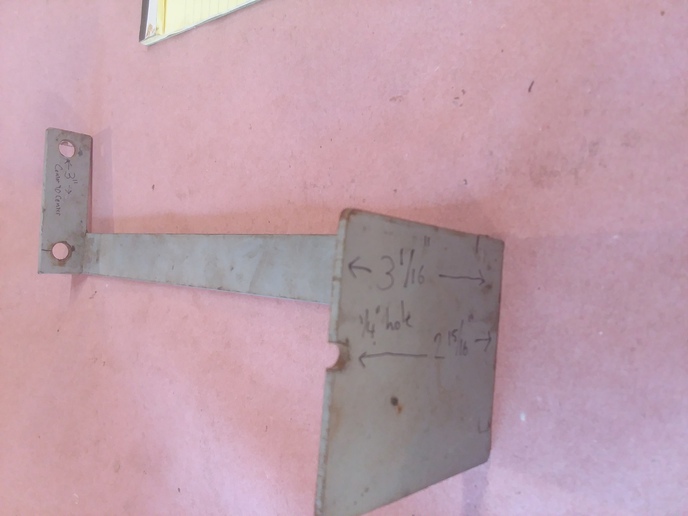

I am looking to see if there is anyone that has Zane's Jig Thang, that would be willing to help me with it. Please contact me at "m r v n m a t t @ y a h o o . c o m" minus all of the spaces between the characters.

Your advice is greatly appreciated, but either I am not doing it right or I am missing something (like a step). I am going to focus on getting one of the gauges or jig's. I have been going to every antique store and estate sale lately. Plus, I have been doing a lot of research to locate one.

Does anyone have the measurements for the second part of Zane's Jig Thang? Or was their only one piece?
