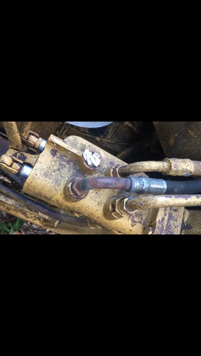

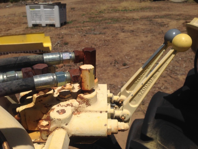

Here is some pictures of what the fitting looks like. Anyone know where I can get this or what it is called?

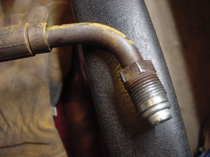

Here is a picture of a fitting that maybe could work in place of the other one. It looks like a pipe thread with a 90 degree connection. Anyone know what this is called?

The 90 degree adapters between your hose and the valve body are 90 degree NPT adapters, male NPT pipe with a female NPT swivel. The hose end appears to be male NPT. You would need to determine the actual size. They look like they might be 3/8" or 1/2" NPT.
Where does this hose go? The end in your first photo looks like one I would expect to see on power steering, or a transmission cooling line. Is that an actual O-ring (does not look like it to me)? It looks like the tube was formed to make that shape for sealing. If that is the case you may need to go to MF for it or find a hydraulic shop that can put that end on a hose fitting. Just my thoughts.

PostPosted: Wed Sep 11, 2019 4:35 am    Post subject: Re: MF 204 loader needs hydraulic hose repair Reply to specific post Reply with quote
The photo that shows the 90 degree bent tubing has an o ring that fits over the short end and butts up against the rounded flair piece.

PostPosted: Wed Sep 11, 2019 5:17 am    Post subject: Re: MF 204 loader needs hydraulic hose repair Reply to specific post Reply with quote
The end of the hose with the 90 degree tube with the o ring goes to the loader control unit like the second picture but with this connector. The other end goes to a steel tube running along the lift arms to the cylinders. I have parts book for the tractor but it does not show any parts for the loader attachment or hoses.

If that is the type fitting on both ends of the hose the adapters will not work, you need those ends.

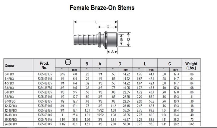

I would braze a straight hydraulic pipe coupling to the old end, then you can have a hose with a pipe fitting end on it to screw into the side of the coupling you didn't braze to. What ever you use get real steel hydraulic components. I hate to see hardware store fittings on the pressure side of hydraulic systems. Most are only rated for 150 psi working pressure. They are an accident waiting to happen at 1000 psi plus. Yes some hold, but I have seen some split as well.
Some hydraulic shops have hose fitting stems that ends like yours can be brazed/welded to, then are assembled by attaching to the hose with a crimp ferrule. Below is a sample from a Gates catalog in the Power Crimp section. Different suppliers may have similar depending on the hose brand/system used.
