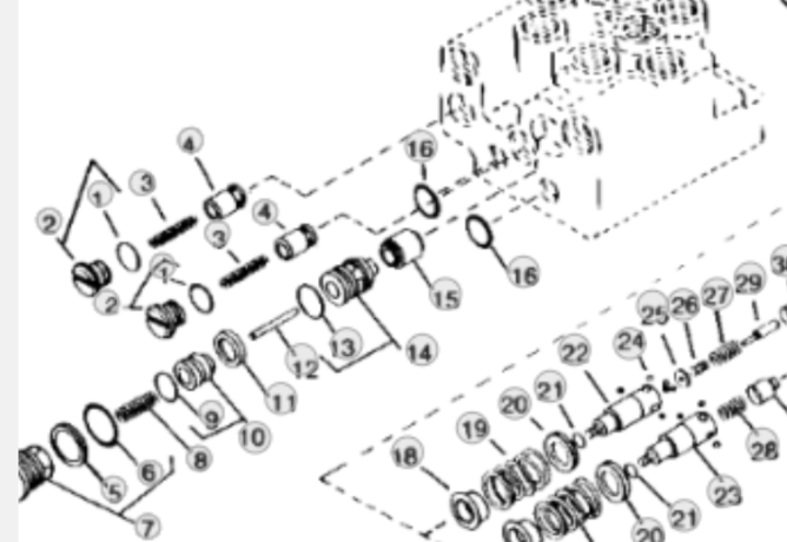

I have a 2640 that is giving me trouble. I have read many of the posts on the subject. One from June of 2016 by cowman79 best resembles my problem. I have a 240 loader mounted on my 2640.
it slowly creeps down, loader arms and bucket roll. The 3 point arms and control lever rise up on there own. The steering valve does leak and gets hot, O-rings are on order. Thanks to Tx Jim, and tim s for there advice on that. I have cleaned the screen and changed the Hyd filter, no smoking gun there. Now I'm going to show my ignorance. when looking in the Hyd filler hole I don't see anything special, no spraying ect., Should I?
In that 2016 post there was talk about the SCV, is that the control valve for the 3 point arms? Tx Jim posted that it was possible that the internal seal on the closed center plug had failed, where would I find that,? on the loader control? OK now you can laugh Embarassed

Closed center plug if present will be located in frt end loader control valve. No oil moving while looking in hyd filler hole behind seat is wonderful. Frt end bucket creeps down is more than likely caused by leaking internally loader control valve. 3 pt control lever has friction washers that is suppose to hold lever in set position until moved by operators hand.

Thanks Tx Jim. In the thread I referenced, someone mentioned a trouble shooting method for the loader control. Something like disconnecting the return line for the loader. If I understand correctly nothing should come out of the return line? Unless the loader control lever is moved? Is there an easy way to Identify pressure and return lines? Both lines come from under rear end. One from the bottom of the filter housing. Would the combination of the leaking steering valve and a bad loader control valve cause over heating?

The good news is that the loader joystick valve is returned in the oil to a ported transmission filter cover .
As stated previously, there should be no oil flow in the return line back to the filter when no loader movement is selected .
If the joystick is open Center or if there is an O ring failure in the closed Center plug. Hydraulic function will be totally botched .

As b&d stated remove quick coupler from hose that attaches to ported filter cover. Aim open hose in hyd filler hole or bucket,with FEL control valve levers in neutral operate engine briefly & if any oil comes out of hose something in FEL valve is leaking which causes tractor hyd's to not operate as designed.

Thanks Guys! If I find that the loader control valve is bad, can both types (open center, closed center) be repaired? I think I read tim s can do this repair.

If loader control valve has a blown closed center plug seal or leaking relief valve those 2 things can probably be repaired. If spool to valve body is leaking then valve can't be repaired because that's a machined fit with very small tolerance.

Followed your instructions today and was a flow of oil. I not a very good judge but I would say about a gallon a minute. Have I found my smoking gun?
Here are some photos of the loader control. Can anyone tell me if it is an open or closed center? do I need to do more trouble shooting to further isolate the problem?

I did not see an open center valve or plug offered in 240 parts catalog. When you chocked for & located a 1 GPM leak was hyd oil at about 200 or hotter? Poppet valve(key 4) might be seating properly.

Or spools/housing are worn allowing leakage.

Oil was not hot. Just disconnected quick couple removed pioneer fitting and stuck hose in fill port cranked up the tractor and ran for about a minute.
Should I get the oil hot before the leak test? In your "Poppet valve(key 4) might be seating properly". did you mean Not seating properly?

Higher temp oil will tend to leak more than colder oil. Yes I meant "not seating properly" but I'll bet the leak is between valve housing & spools.
