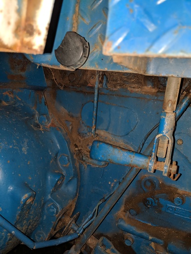

I just purchased a Ford 7000 (7200) tricycle wheel front end. I noticed what looked like a linkage unhooked on the rear above the axle. Is it supposed to be attached to something.

I cannot get an photo to attach. It's under the platform about 6 inches behind the "Selector Pull" Knob. The "linkage" is attached to a mechanism in the case.

PostPosted: Thu Sep 12, 2019 6:31 am    Post subject: Re: Ford 7000 Questions Reply to specific post Reply with quote
Heagon,
There are several "linkages" in that picture, but my guess is that you are asking about the differential lock.
It locks the rear wheels together to get you out of a tough spot (or digs you in even deeper, LOL!).
HTH

I was referring to the small rod that is dangling there, is that part of the differential? If so, where should it be attached at, as it just says back and forth? I feel like an idiot but I can't find where it attaches to. Lol

It appears there is round bar link hanging down, unconnected on one end. It is about 1/4" in diameter with a 90 degree bend on each end...about 8" long overall. My guess is that is the link that connects to the lever beside the seat that controls the three-point lift Just a guess. Hard to get oriented from that picture.

Yes, that is the rod I'm referencing. I will go check and see if that's where it goes. Thanks!!!

I sold my 7200 in 2003. In my mind, I remember controls for the Diff lock, ASC service valve, and the brake lock being in that area. The flow control knob is the one out the side of the deck.
So my next guess would be the brake lock. ??

Looks like the rod that hooks to the position/Draft control that is up inside the support for the seat. Don't you have a chrome lever on the right side behind the seat? This is a row crop 7000 (7200) isn't it?

(quoted from post at 14:21:11 09/12/19) Looks like the rod that hooks to the position/Draft control that is up inside the support for the seat. Don't you have a chrome lever on the right side behind the seat? This is a row crop 7000 (7200) isn't it?
Yes! Thanks! I went and checked this morning and that's where it went! Another question though, where is the hydraulic filter located on a 7200?
