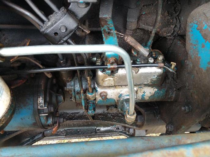

I wanted to add a couple of pics to make sure i got the bleeder screws right. the small one is on the side of the pump and the other one is on the (return)?? I am not getting any fuel to the larger bleeder screw

I added a couple of pics on here if you can look at them I appreciate your alls help can you tell me what these little lines are for?

The individual line in that last picture is the injector line going from the pump to that injector. The fitting above that which has two lines connected to it are the excess fuel return lines. One line goes from the pump to the first injector, and the next line goes from the first to the second injector, another form the second to the third, and the final line goes from the third injector to a fitting on the neck of the fuel tank. If yours has the Therm-O-Start feature (manifold pre-heater for cold starting) then there would also be a tee fitting or a small reservoir in the line going back to the tank that feeds the Therm-O-Start module.

Fuel return from the pump and injectors back to tank.
