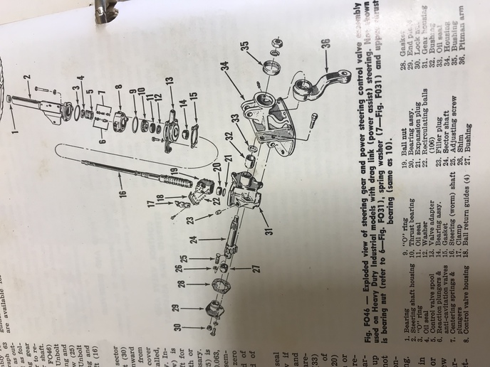

Still working on getting the 4140 together and discovered a power steering leak at the top of the column, see picture. I m looking for insight on where to start. The rest of the sheet metal is off and so getting this exposed will be no problem.
Thank you!

PostPosted: Mon Sep 30, 2019 10:57 am    Post subject: Re: 4140 Industrial - PS leak at top of column - see pic Reply to specific post Reply with quote
Looking at the exploded view, my guess is #3 or #4 or both.

PostPosted: Mon Sep 30, 2019 5:00 pm    Post subject: Re: 4140 Industrial - PS leak at top of column - see pic Reply to specific post Reply with quote
#3 no. #4, definitely.

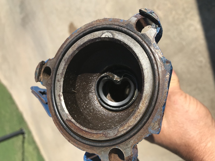

CVPost-Bern wrote:
(quoted from post at 18:00:21 09/30/19) #3 no. #4, definitely.
Been you re right. When I disassembled it, the oil seal was intact but looked a little wonky. I went to the local seal store and ordered one, actually two. It seems no one has inventory anymore and so I m three days away from reassembly.
But, I am now concerned that the leak, albeit small, may have pressure behind it - since the system has to hold considerable pressure. That oil seal won t hold much pressure - actually I don t know how all of this works so I m probably worried about nothing. I destroyed the seal removing it but here is what it looks like.
Thanks again!
Back to top
View user's profile
Threewilsons
Regular
Joined: 09 Feb 2019
Posts: 49
Report to Moderator
PostPosted: Mon Sep 30, 2019 6:00 pm    Post subject: Re: 4140 Industrial - PS leak at top of column - see pic Reply to specific post Reply with quote
Bern, not Been! Spell checker got me and I can t edit for some reason.
Thanks again Bern.

Bern
Tractor Guru
Joined: 05 Apr 1999
Posts: 7173
Report to Moderator
PostPosted: Mon Sep 30, 2019 7:30 pm    Post subject: Re: 4140 Industrial - PS leak at top of column - see pic Reply to specific post Reply with quote
There shouldn't be a lot of back pressure against that seal. If there is, you have some sort of excessive
restriction in the return side of your pump reservoir, like maybe a plugged filter.
I don't know for a fact that the filter is on the return side of the system like it is on the later models,
but if it is, a plugged filter could definitely be the reason for the seal leak.
