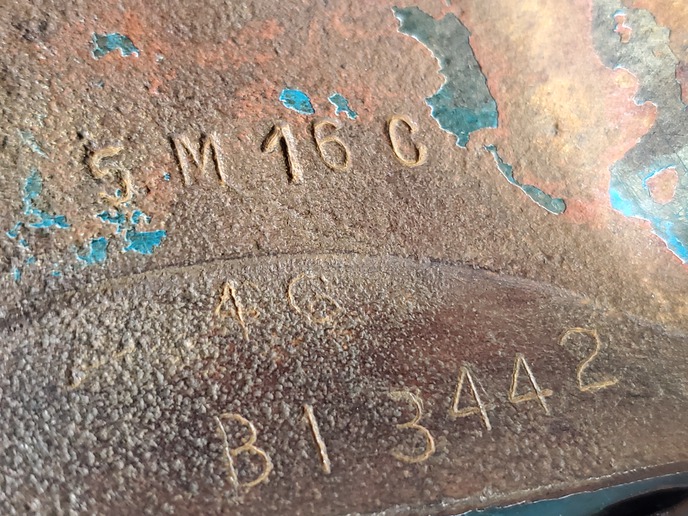

CVPost-Shaun Wallace wrote:
(quoted from post at 08:41:36 10/02/19) It may have live pto but clutch may not be adjusted correctly. Have seen this a few times over the years. Of course posting numbers off foil sticker or off machined surface to rear of starter will tell the real story.
I am wondering also if my 3000 has live PTO or not, Here are my numbers. Can't read the middle set of numbers

nashranch, yours was build Dec 16, 1965 in Basildon, England
Unfortunately the middle row is the model ID numbers that tell what it has.

PostPosted: Wed Oct 02, 2019 1:11 pm    Post subject: Re: Ford 3000 live pto Reply to specific post Reply with quote
Destroked 450 wrote:
(quoted from post at 09:36:04 10/02/19)
They did a C r a p p y job of stamping on this one. All I can read is 46 or 4C on the middle row

nashranch, it looks like there's another 4 off to the left of that 46 or 4C. Try a pencil rubbing on a piece of paper to see if you can bring up hose missing numbers.
46 makes no sense as part of a 1965 3000 model number, and nether does 4C, but 4C does make sense at the end of a 4000 series model number as the 4 would mean independent 540 rpm PTO and the C would mean an 8 speed transmission. A 3000 with an 8 speed was only available with live or non-live PTO, never Independent PTO. So maybe the transmission was swapped out at some point?
