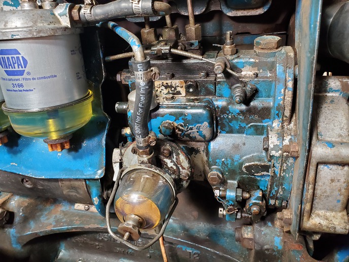

PostPosted: Wed Oct 02, 2019 6:07 pm    Post subject: Re: ThermoStart installed on 3000 today Reply to specific post Reply with quote
Bern I know nothing about a cold start button on the injection pump. here is a pic of the Simms inline pump I have

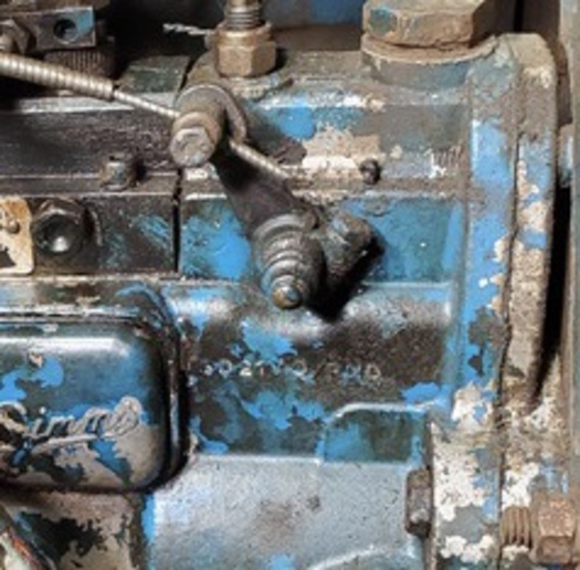

PostPosted: Wed Oct 02, 2019 7:00 pm    Post subject: Re: ThermoStart installed on 3000 today Reply to specific post Reply with quote
Excess fuel button in on the shut off cable fulcrum on the pump. Half throttle, push the corrugated button in, it will click and stay in. Rack goes to full fuel. When the engine lights off move throttle up and full fuel will cancel. White smoke is poor heat, incomplete combustion.

PostPosted: Thu Oct 03, 2019 6:51 am    Post subject: Re: ThermoStart installed on 3000 today Reply to specific post Reply with quote
The rubber button is just below the end of the shut off cable in your picture. Fuel leaks by the plungers in the pump and dilutes the oil. Use extreme caution in replacing the drain and level plugs in the aluminum body, very easily stripped out.

PostPosted: Thu Oct 03, 2019 6:57 am    Post subject: Re: ThermoStart installed on 3000 today Reply to specific post Reply with quote
Cold start button is in the end of the shut down control
Button is the outer part of the shaft, then there's the rubber seal and then the shut down lever.
Lever must be in the run position before you can push the button in, throttle must be opened above idle in order for the button to stay in.
Once the engine starts or you move the throttle to idle the button will pop back out.

(quoted from post at 07:51:11 10/03/19) The rubber button is just below the end of the shut off cable in your picture. Fuel leaks by the plungers in the pump and dilutes the oil. Use extreme caution in replacing the drain and level plugs in the aluminum body, very easily stripped out.
Thanks Ernie... I just found the rubber button you push on the shut off lever. It push in and click when the throttle was about half.
Hopefully pushing that in will make this tractor start better when it's cold. I still gotta refill the pump with fresh oil

PostPosted: Thu Oct 03, 2019 4:03 pm    Post subject: Re: ThermoStart installed on 3000 today Reply to specific post Reply with quote
She started pretty good this morning using the cold start button on the injector pump. It smoked real bad for a bit till it got warmed up. Hopefully this gets better with time.
