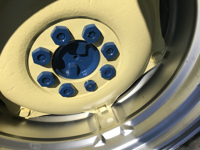

It takes a 1-5/16 inch socket to fit these large lug nuts on the rear of my 4140. They also have a "snout" or shoulder about 1-1/8 inch diameter that fits through the thick wheel center. You can see in the pic that I need one - just one. The thread is the normal 5/8 inch fine thread.
I know that just about everything else in the world is more important than this but maybe someone has one. I did try Messicks but no luck.
Thanks,
-Joel

What your describing sound similar to the lug nuts on my 69 4000 with cast centers, But mine have 3/4" threads and won't work for you.
Google C5NN1120D, there's some on eBay that look like the larger shoulder size you need but not sure about the snout.
May be the closest thing one can find today.

Has 24" cast centers. Destroked has correct p/n. Took while for me to find it. Also used on 34/3500 with 24" wheels

The C5NN1120D lug nuts are still available from Messick's for $27.95.

Well there it is on Messicks when you search the part number. When you go to the parts diagram, you ll see a replacement but the pic clearly shows it s not correct.
Googled ebay with the part number and saw the one for $25. Holy cow, take a deep breath Joel and sleep on it .

Here's a couple of photos I found of the only two lug nuts still available for those tractors.
Standard lug nut # 554480R1
Heavy duty lug nut # C5NN1120D
It doesn't appear to have the snout but does have a flat area where the snout may have been on the originals and should match in size.
This is probably the closest one is going to find to the originals without searching thru salvage yards since the cast centers and original style lug nuts were discontinued long ago.
Don't feel to bad about the $25 price tag, the same style lug nut in 3/4" for my 69 4000's cast wheels are $43.52 each

I m certain that the last pic is what I m looking for. The "snout" is looking straight at you and protrudes about 1/4".
