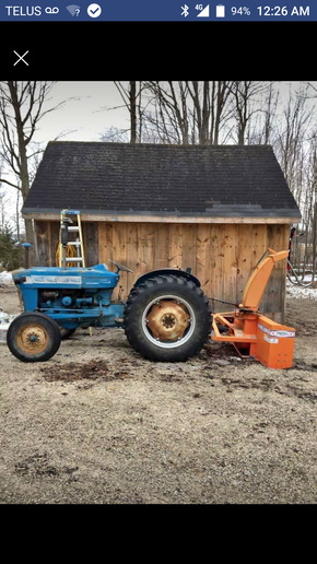

Hey Guys,
Looking for some advice on what to look for when buying a 3000 and if the tractor im looking at is a good deal or not. Ive owned an old Ford 8N for a little while and am looking for something a little newer with a few more add ons and power of course. Going to be using it for snowblowing and work around the property. Its advertised as a 1967 Ford 3000 Diesel 3 Cyl 47 HP. Comes with a agro trend 6ft blower, which has only be used a handful of times and was bought 3 years ago from brand new. Has live PTO and 8 speed trans, that's about all the info ive gotten so far and the only thing that has been a concern to me is the hours, it has 7000 hours on it, now I could be totally wrong here as I don't know much about the diesels but is ths considered high hours? I know the diesels usually last a long time but don't really know what kind of hours would be high? what should I be looking out for? tractor has new battery,starter and block heater last year and apparently runs great, they said they would take $4500 Canadian for it wth the blower, what do you guys think?

Long post. Random thoughts:
$4500 CA = $3370 US
so to begin with the tractor with the
blower is a pretty good to very good
price. I don't know the brand of blower
but you rarely (never?) see a decent 2
stage blower here for under $1K US.
The HP rating is off by about 10.
According to the Nebraska Tests a 3000
diesel should put about 38 hp out the
pto.
If it is actually 7K hours on the proof
meter that is about as high as I have
ever seen one of those tachs go.
The 65-75 tachs/proof meters were
notoriously failure prone and rarely
registered over 3-4000 hours before
going kaput. My guess is it doesn't work
now and the tractor has more hours than
that.
Others here can tell you more about high
hours on a diesel than I but I think
with good maintenance a 3 cyl should go
10K before it needs overhauled. But at
that point it would need a complete
reman - bore and sleeve, crank ground,
major head work, etc. Also, there's the
pump and injectors to consider.
I would be asking if any engine or pump
work has been done to it.
You know enough about tires, clutches,
gears, working hyds, water in the oil or
oil in the water from owning an N to
inspect/inquire about those.
That model is a Very Good machine.
Pretty much bullet proof.
50 - 60% more HP than an N, plus you say
it has live PTO, much better/more gears,
live hyds, maybe differential lock and
it looks like power steering on it - all
on a platform not much bigger than an N.
I started on Ns and now have a 3000D and
would cry if I had to go back to an N.
And I wouldn't go back to a gasser
either. Diesels Stink and those 3 cyl
Fords are Noisy. But they don't have
points and carbs and bad gas to fool
with. They just run. They always run.

Condition is everything.
How does it start cold? does if fire right up? Do you have to crank it for a long time? do you have to give it ether to fire off?
When it fires off, does the exhaust clean up within seconds or blow white smoke for a long time or continuously? How does it sound and run?? How does it drive?
You can easily spend $4000 or more for an major engine replacement or rebuild, so engine condition is everything.
Diesels are harder to start in cold for snow removal, but an engine/block heater solves that problem if you can park the tractor close to power.
If the tractor starts good, and check out good, I would not worry about hours. On the other hand if it barely runs, wont start, missing gears, needs a clutch, pours oil and hydraulic fluids everywhere, your better off passing.

It's unusual for the smaller hp tractors like that one to accumulate that many hours without engine work but it does happen.
Ask if any work has been done.
That model has the Sims inline injection pump, ask if the oil as been changed in the pump, if not I'd be concerned about the pumps condition.
If it actually does have 7000 hours with no work done to the engine, at minimum it'll need a set of injectors soon.
After enlarging the photo I don't see a power steering pump so I'm going to say it does not have power steering.
If the snow blower is worth $1K US then the tractor is only $2370 US, that's cheap for that model, but if the inj pump needs work you'll be into it for what it's worth, if the engine needs work you could be a little upside down in it but would have a fresh engine that will last for years.
If the engine's tired and the oil hasn't been changed in the inj pump I'd walk away.

If the snow has any depth or packing to it, be prepared to use the clutch a lot.
The normal reverse gears in really old Fords (like N series) would give the Starship Enterprise a run for its money at warp 7. If it had the Sherman step up? Forget about it. Just close your eyes and pray you stop in time.
The 3000 has two reverse gears. High range is even faster than an N. Low range would be about as fast as an olympic sprinter wearing ankle weights...
I've used a six foot, two stage blower behind an IH856 back home growing up. Even with eight reverse gears and a torque amplifier, if you were going through a packed drift, you would be clutching a lot.
If you're just skimming six inches of fluffy stuff off of the driveway, you'll be fine.

It's a very early 3000 but it does have one of the good transmissions.
That's a BIG blower for any 3000.
Do not see power steering.
PTO HP is more like 38.
7,000 hours! Hard to believe.
