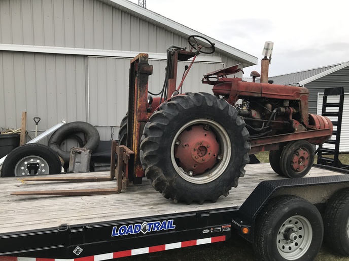

I have a set of clamp-ons that I have used for years.
Actually, this is my second set. I bent the first, light duty set.
I also have a pair of 3 pt forks. The 3 pt forks do not wander.
They also do not lift very high. But they are heavier duty.
Other than the visibility problem, there is also an arc to a loader.
If you want to lift a pallet full of "stuff", it tilts back as you go up.
So you have to be mindful of adjusting the tilt if you don't have
a self leveling loader. That was always a pain for me, but that's not
what you are planning to use it for. At least not yet.
I picked up an old orchard forklift. Handy as a shirt pocket!
Didn't cost a whole lot more than the new clamp on forks were.
It also has tilt and side-shift.
But I do have to store another tractor.
