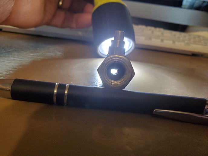

PostPosted: Wed Oct 23, 2019 8:06 am    Post subject: Re: Diesel Compression Tester Reply to specific post Reply with quote
I took a few pics of the check valve, you can see clear thru it

PostPosted: Wed Oct 23, 2019 9:30 pm    Post subject: Re: Diesel Compression Tester Reply to specific post Reply with quote
Check the end where the quick coupler is, there should be something that looks like a tire valve stem core screwed into the hose fitting.
I'll try to look at mine to see where it's at, but my SnapOn gauge has the same style thump release yours has.

PostPosted: Thu Oct 24, 2019 9:36 pm    Post subject: Re: Diesel Compression Tester Reply to specific post Reply with quote
You are looking in the wrong place for the "check valve".
It's either in each individual port adapter, or in the quick-disconnect coupling.
I have a VERY similar imported set that I bought on Amazon several years ago, I'll try to remember to look tomorrow and see just where the check valve is.
It works very well, BTW, and, likely, so will yours when you figure out just what's going on.

PostPosted: Fri Oct 25, 2019 6:26 am    Post subject: Re: Diesel Compression Tester Reply to specific post Reply with quote
I've taken all the lines and fittings apart and there is no check valve anywhere

PostPosted: Fri Oct 25, 2019 6:43 am    Post subject: Re: Diesel Compression Tester Reply to specific post Reply with quote
Looked at my SpanOn gauge and the valve is at the bottom of the quick coupler.
Look inside that brass 90 to see if there's threads for a valve stem, may have got left out.
You may have to get a coupler or fitting to work with your gauge set or go back to HF even though it's been awhile, they may be able to get you the part you need.
