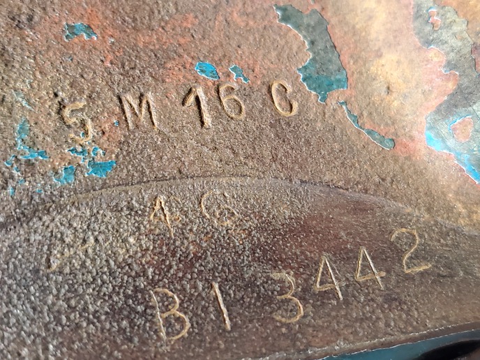

The second to last character in the model number will tell you what kind of PTO it has. The model number for a 1965 3000 should start with 310, then the next character would be a 1 for a diesel engine or a 2 for a gasoline engine. The next one would be a 2 for non-live PTO (single clutch), or a 3 for live PTO (double clutch). The last character tells you what transmission it has.

PostPosted: Fri Nov 08, 2019 8:42 pm    Post subject: Re: 1965 Ford 3000 PTO engaging problem Reply to specific post Reply with quote
all the numbers i have Sean are in the pic below.... it's British

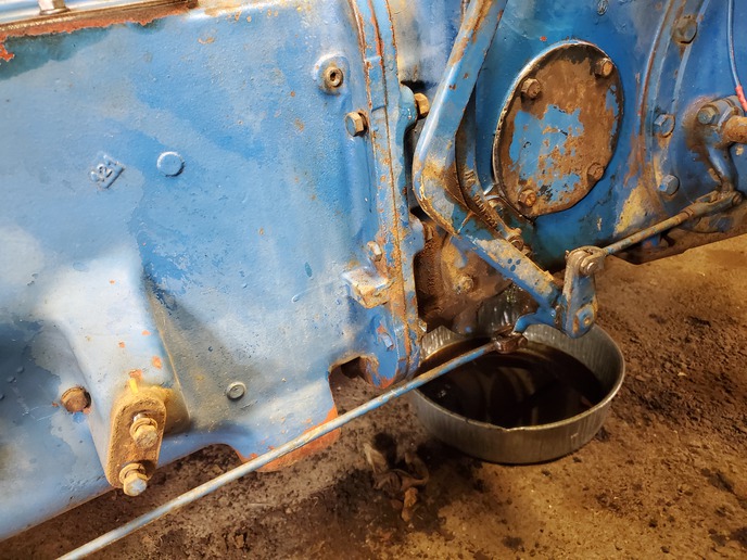

PostPosted: Sat Nov 09, 2019 10:56 am    Post subject: Re: 1965 Ford 3000 PTO engaging problem Reply to specific post Reply with quote
The piece on the clutch shaft has been broken and welded plus the stop bolt is broken off....
Can i pull the clutch shaft out without splitting the tractor? I'm sure the answer is NO but i thought i'd ask.
Also the clutch pedal comes up way too high. That whole left running board has been farmerized at some point.

PostPosted: Sat Nov 09, 2019 2:23 pm    Post subject: Re: 1965 Ford 3000 PTO engaging problem Reply to specific post Reply with quote
Having the clutch pedal high is what you want for a two stage clutch and live PTO. If it's adjusted (or welded) that high and it's still not disengaging the PTO clutch when the pedal is pushed all of the way down, then either the PTO clutch is sticking or it needs to be replaced.

PostPosted: Sun Nov 10, 2019 1:57 am    Post subject: Re: 1965 Ford 3000 PTO engaging problem Reply to specific post Reply with quote
From your picture the clutch adjustment bolt in the lever has
been broken off allowing your clutch pedal too much movement and
your clevis pin is in the wrong hole, it should be in the second
hole for PTO work correctly.
This picture is of a Fordson Dexta but it is the same system.
Note the adjustment bolt for pedal height and the two holes in
the clevis.
You would need to split the tractor to get the shaft out as the
clutch release bearing fork is bolte to the shaft and there is a
big spring to release.
