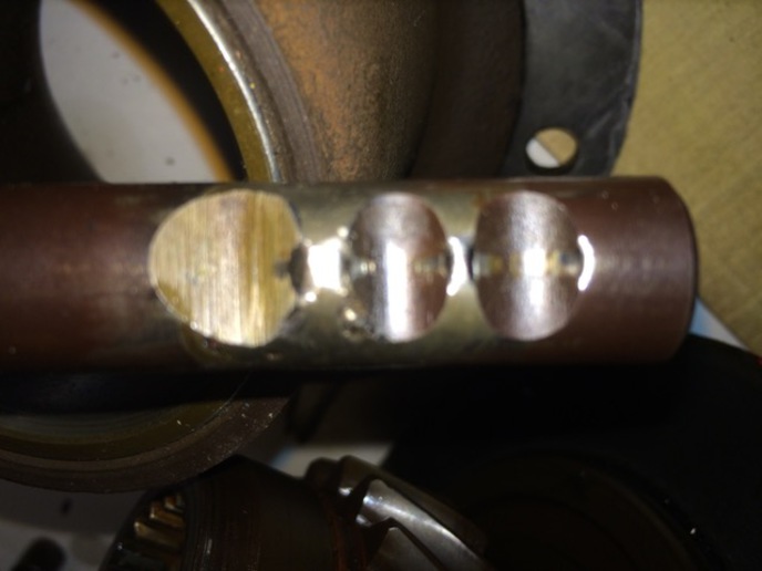

pomester
Long Time User
Joined: 04 Mar 2016
Posts: 554
Report to Moderator
PostPosted: Mon Nov 18, 2019 6:32 pm    Post subject: Re: ford 860 not staying in 3rd gear Reply to specific post Reply with quote
this is 4th gear in a 961, but the mechanism is similar across all the gears -
in this case, I was unable to shift into 4th - the sliding coupler did not fully engage the teeth and finally worked no more - I replaced the whole shaft assembly, which cured the issue - I did not really analyze what happened to the original - I found evidence someone had been in there before and cobbled things - I replaced the shift detent shaft also, as it had been ground on -

View user's profile
T L
Regular
Joined: 05 Apr 2011
Posts: 67
Report to Moderator
PostPosted: Thu Nov 21, 2019 8:24 pm    Post subject: Re: ford 860 not staying in 3rd gear Reply to specific post Reply with quote
Thanks for the pictures. My third gear looked about the same so I ordered a new gear from this site. I have pulled the transmission out and took everything apart. It wasn't hard but took a lot of time. Thanks for every ones help.
