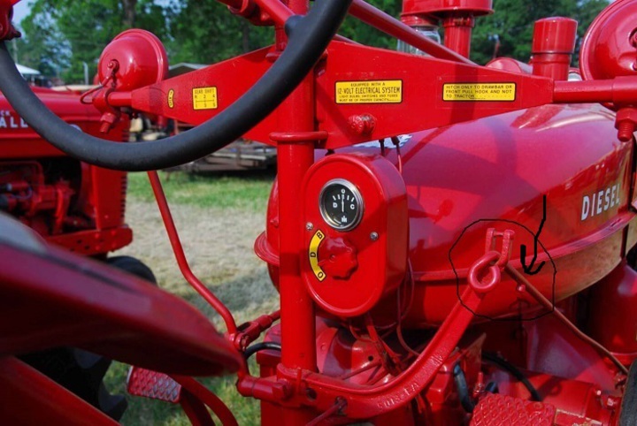

I have a 1951 Farmall M that was stuck badly and I fixed all that. It now runs very good. I now am figuring out the hydraulics that I think work good also, but have three questions with pictures.
Q1. Where do you fill the hydraulic oil at in the tractor? There looks like an inlet on the top right side of case and inlets on the left side of case. I just want to make sure.
Q2. Where is the hydraulic oil level? I can see the two inlets on the left side and maybe one is the oil level.
Q3. The lever that actuates the hydraulics hits the case of the tractor by the bell housing. Is there a proper way to keep that from happening? Outside of putting a stop on the case or the control rod by the dash.
I bought an IT Q8 manual but it does not say anything about these basic things.

The two pipes coming out of the left side are pressure outlets. The one on the right side is also a pressure outlet. The pipe coming out the top on the right side is where you put oil in, there should be a dipstick under the cap and that is not the cap that belongs on the top pipe. It should also be vented.
The lever has prongs that engague slots in the control shaft in the pump, loosen the bolt that holds the lever on and see if the prongs are in the slots.

The fill port is circled in black and holds 6 quarts.
Your has been changed. It should have a screw on cap with a dip stick.
The lever fits into slots on the control arm in the pump. Yours may not be installed correctly.
There should also be a piece welded on the control rod to hold it in neutral at the bracket on the steering post.

That little knob is on there!

Fast that picture showing the rod from the back posted by Rodney is not of JEK1?s Tractor. Notice diesel and shiny paint. Nothing against you just trying to minimize confusion in the thread.
