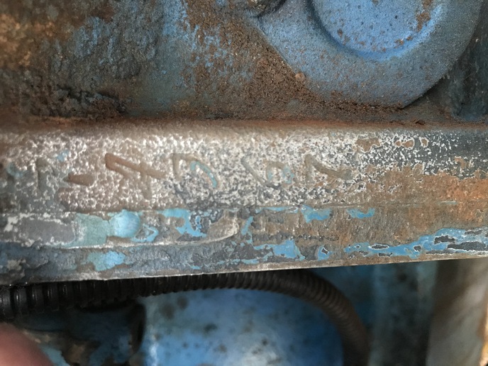

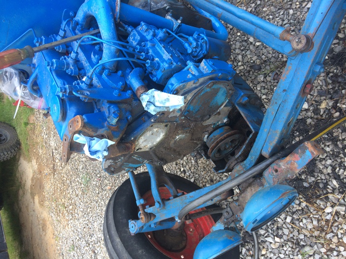

thanks all for the replies. So, far since my last post I am now certain I have diesel in the oil pan. Where the leak is I don't know yet I have to get it up to my shop.
I think I have found the serial number and I am going to try to upload it and also a "Side shot" of the simms. I think I can make out 74967 but I will continue to look at the other places suggested.

PostPosted: Tue Nov 26, 2019 8:56 am    Post subject: Re: Fordson Dexta Diesel Needs HELP!! Reply to specific post Reply with quote
The pics are too close and still too high of an angle. I need to see from the front of the timing/drive gear housing to the back of the fuel filter in one shot. That way you can point out where the diesel fuel is coming out and going onto the ground.
If you remove the side cover of the injection pump gear drive housing you might see signs of a leak where the pump stud enters the rear of the cover.
If the serial number is 14967 or 4967 it was made in 1959.
Serial numbers from 144 to 22558 have a production date of 1959.

PostPosted: Tue Nov 26, 2019 10:18 am    Post subject: Re: Fordson Dexta Diesel Needs HELP!! Reply to specific post Reply with quote
Ok..so you want a photo viewing from the front of the tractor looking at the injector pump assembly toward the fuel filter, in one shot. I think I know what you are wanting and will post later after work.
I think you are referring to the "plate" that has 2 bolts holding it in just to the left of the fuel pump and NOT the plate on the injector pump that has the SIMMS embossed on it..Right?

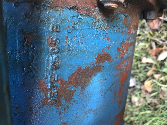

PostPosted: Tue Nov 26, 2019 10:30 am    Post subject: Re: Fordson Dexta Diesel Needs HELP!! Reply to specific post Reply with quote
thanks for your input..I did find a cast A10B I think and I am attaching a photo of it..I did see a 957E number and took a photo also.

Deutz Lover
Long Time User
Joined: 21 Aug 2015
Posts: 1189
Report to Moderator
PostPosted: Tue Nov 26, 2019 2:43 pm    Post subject: Re: Fordson Dexta Diesel Needs HELP!! Reply to specific post Reply with quote
Yes, that is correct. I have not removed the plate on mine, but you might be able to view the drive gear and look with a flashlight to see if there is any signs of diesel fuel driping out the shaft seal. I am not sure if this will work. I guess I will have to remove mine and see if this is visible sort of like when they have a space capsule with problems and NASA duplicates the procedure on the ground or in a swimming pool.
