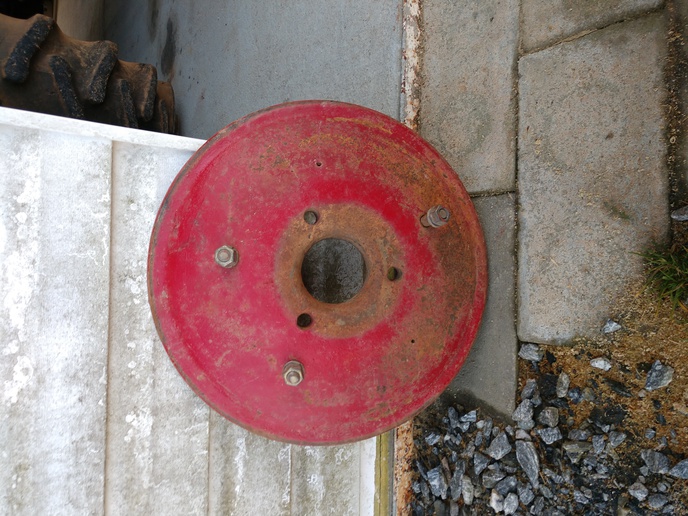

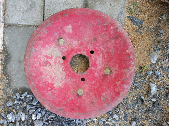

Found some good used Ford 8N fenders and he also had some wheel weights. Gentleman told me these were wheel weights for an 8N. I don't need them but they were cheap enough so I bought them. I got them home and they don't look like they would go on an 8N.
Does anyone know what they might go to? Hope I can get the photos to upload.

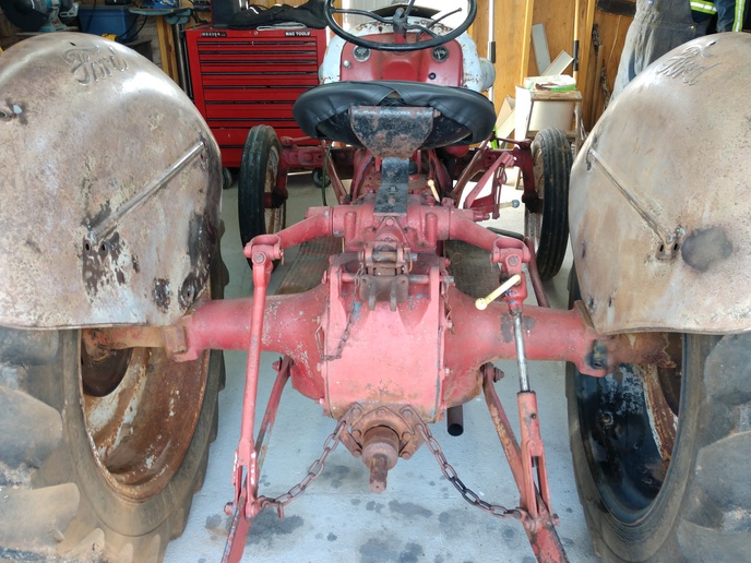

The fenders cleaned up nicely. Have to do a little body work but are way better than what was on it. Couldn't believe I found them 15 minutes from home and all he wanted was $60 for both together. I am very happy with them and tickled they have FORD stamped in them.

To me, the wheel weights look generic. They would probably fit
on an 8N if you drilled holes in your wheel centers for the bolts.

I have seen and priced the aftermarket fenders to mount on my brackets but just happened to find these last night with the brackets still attached to them also. Mine had the fenders without the script and from what I had researched that was how it came.
I decided $110 wasn't too bad a deal for 2 fenders with brackets and 2 wheel weights. ( I was only going for the fenders for $60 we had found LOL ) The guy showed us the weights and I knew I could always resell the weights if they weren't what I want or need. Anytime I don't get something and go back for it, it is always gone and I wish I had gotten it.
The weights threw me off by the holes because my wheels aren't predrilled for weights I noticed when I got home.
I was really surprised how well the fenders cleaned up. I was hoping after I got the rust wire brushed off them they would be decent. My husband and I straightened out a few dings and we will work on the few small rust holes they have. I'm just excited that I found some original fenders to save.

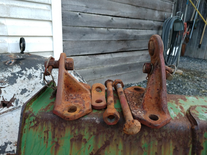

Can anyone tell me what these parts were for? They were mounted under the rear axle with the fender bolts. They are different sizes and shapes. I forgot to take a pic before I took the off.
I managed to figure out the bracket on my new old fender was a grease gun holder.
Thanks for your help!

Left one looks like the bracket for the stabilizer bars.
Right one a combination bracket for the stabilizer bar and a
sickle bar mower. I'm not sure if Dearborn or Ferguson.

I wondered about that but they looked different from the ones I see for the 8N. Thanks so much Royse!
