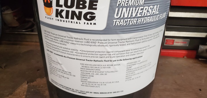

I just bought 5 gal. of Lube King Premium UTF for $44.99 . It is Ford 134 compatible. The last jug of 90wt. Mineral Oil was about $65 so this time i went with the UTF
