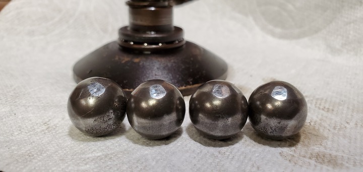

I would replace them.

I be that with a few hours of meticulous file work you could get another ten years out of them!

I thing they are available separately or a bearing company would have them. I think they are 5/8 diameter.

McMaster has a box of 50 available for under @10.

Most any tractor parts store should have them #358081. Or like Bob says McMaster/Carr.

nashranch wrote:
(quoted from post at 16:40:28 12/06/19) I took apart the governor today on this 46 2N I'm working on. Discovered twp little flat spots on each ball. Are my balls worn out or do you think i have another 73 years of wear.
$1 each to replace with new. I wouldn't even think twice about it. Find something(s) else the machine needs and place an order and replace. For $4 not something you want to have come back and give you trouble later.

How does the driveshaft off the governor look particularly the area where the balls ride?

Easy fix, just replace the balls. You should also consider the upper and lower race as well. Those flat spots are there because they hung up and stopped rotating a while ago. It suggests that they nested against the race and started riding in one spot. So while you have it apart do the right thing and get it back to full function.
You will be happy you did.

I think you could get another 73 years out of them! Rolling Eyes

I just opened up and inspected my governor. The balls only had small flat spots that were not too bad. The lower and upper races were totally pitted and chewed up. I suspect the previous owner replaced just the balls to get it running to sell it. I just ordered the whole rebuild kit. Only want to do this job once!
