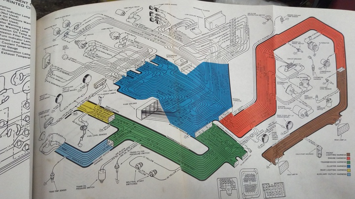

Can anyone provide me with the electrical diagram for a Case 2090. It is hard to blow snow without lights

If you lost just front lights check the connector on the right side below the alternator may have severe corrosion.providing you don't have a blown fuse.tried to post a pic of schematic but couldn't,there is also a connector under the can that is troublesome,at least in my area.

Schematic

Check the plug under the cab near the steps.

The plug under the alternator is good. Lights work when power applied. Going to find plug under cab. I took the dash apart to get to the resistors, etc. no problems there. When I put the dash back together the tach is not working.
I'm considering running a wire from the switch to the top work lights.

If there is power to the switch that will work. Make sure the fuse is before the switch.
