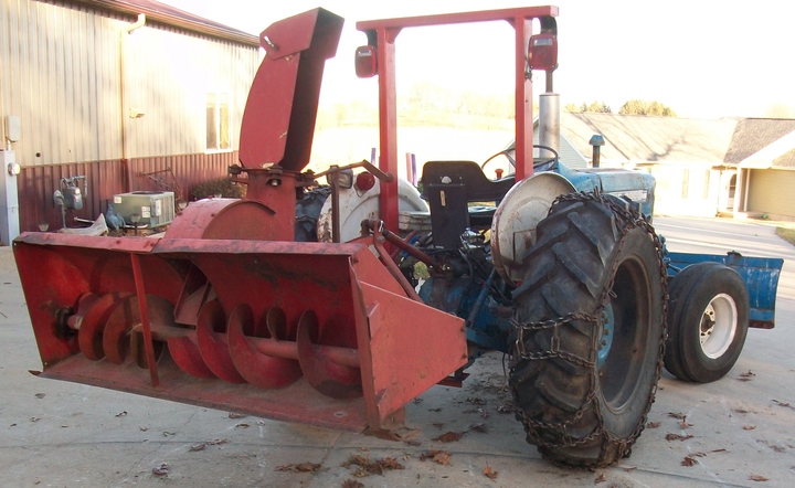

Sometimes I think my snow moving 3000 was allergic to or afraid of snow! Got all the wires done correctly, the right plugs, electronic ignition, carb rebuilt, etc, etc, etc,..... Now it starts easily & runs great!
