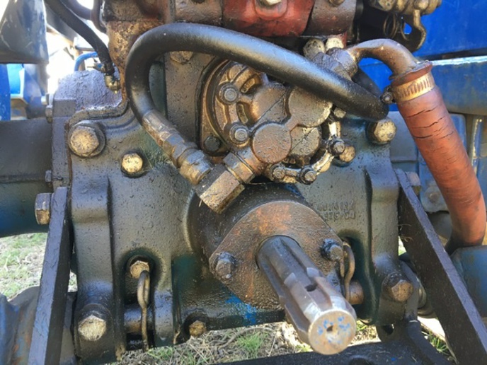

I ve had had a 1980 s Long 360 w/ the KMW Loader for a few months. I can find a replacement hydraulic pump for the front end but not the pump that mounts above the PTO in back.
I know some other tractor model pumps work but don t know which or where would be best to get one. The pump I have now works but everything is eventual.
I m also wondering if the hydraulic fill next to the PTO lever on the left hand side and the port underneath the right side of the seat go to the same place.
Any info would be appreciated, I m still searching through posts to see if these questions have been answered before. Thanks!

On most of those loaders the loader has the fluid in the loader arm on the right side of the tractor facing forward.I think Import Tractors sells those pumps

Thanks for the info. I had to replace the starter & fuel filters when when I got It so I ve worked on it a little. I saw the pump in the front end, had to take it off to remove the starter. This rear pump will be the next project as it s leaking a bit.

Will add a lot of the Fiat built tractors had that same pump like the Oliver 1365,AC 5040,etc.

Call Rick Stair at Rick's Ag parts on Wooster Ohio. He can get you a pump, I'm guessing for $200 or so. I got one from him for the three point and remotes that mounts on the engine, pump, coupler, gaskets and o rings with shipping was less than 200.
