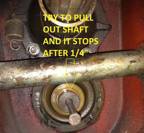

It's taken a while, but I finally got the old tractor split open and after a couple of days of work am nearing the "end game" for replacing the seals/gaskets. I'm now to the final seal- the one behind the transmission shaft retainer- and I'm stuck. The retainer housing refuses to slide off of the PTO drive shaft and I don't want to use a pry bar with too much force to risk damaging something else. Has anyone gotten these off and what steps do you recommend?

I am trying to follow the service manual and it says the shaft can be pulled out through the front viewed here. I looked up the Youtube video recommended by you folks (thanks!) and that gentleman used a punch to punch the shaft out through the back. So there's a difference between that model and this one. See the manual snippet I've uploaded here.
The manual says to remove the snap ring shown in the color photo, and I'll be darned if that sucker is even going to budge. I used a flathead screwdriver like I did on the rear PTO shaft snap rings last year, and tonight, punched a hole right in the bearing. So that'll be replaced. But without the ability to remove this snap ring means I can't remove the shaft. I'm at my wits end with this thing and am about to find a mobile mechanic unless someone has some thoughts about it.

Thanks for the post! I'm up to step 14 and Bundy Bear on Youtube prefers to punch the PTO shaft backward. I don't have the luxury of removing the entire gearbox, so I'm trying to follow the manual. But now the PTO shaft is stuck when I try to pull it out through the front. I have about 1/4" of free play in and out with the shaft, but it's binding up on something, and the parts diagram along with Bundy Bear's video shows there shouldn't be anything holding it in other than slip-fit gears.
Are there any tips for getting this shaft to slide off the gears? Would a slide hammer attached to the bolt (photo shown) work well in this case?
By the way, I had to cut the PTO shaft snap ring in pieces in order to just get to where I am now. This project just keeps getting better!
