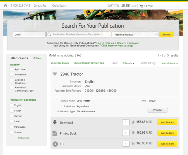

If you are going to do this start by getting the John Deere Technical and Operator's manuals for it. There is diagnostic info to help pinpoint the issues and recommended fixes. The manuals give you a guide to nomenclature and the systems, then members here can help with questions you have.
This site has some manuals, I don't know if they have reprints of the JD manuals or something else. You would need to call and confirm what they have.
You can find the OEM JD manuals (printed, CD, or downloads) at
https://techpubs.deere.com/Products/ProductSearch.aspx. There is a phone number (1-800-522-7448) there if you want to talk to a person to confirm the right manuals.

I'll 2nd what Jim.ME stated. You need to acquire TM1220. It surprises me that the printed or CD or downloaded versions are priced so close to each other.
