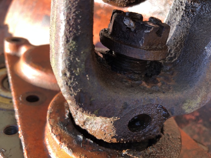

I need to remove the yoke attached to the gearbox. The main seal is bad and needs to be replaced. The seal goes around the yoke and into plate behind yoke. Any suggestions on how to remove the yoke? I've attached pics. Thanks,

PostPosted: Fri Mar 06, 2020 1:59 pm    Post subject: Re: Howard Rotavator Reply to specific post Reply with quote
As badly rusted as that yoke heat might be you best friend to get it loose.

PostPosted: Sun Mar 08, 2020 6:26 am    Post subject: Re: Howard Rotavator Reply to specific post Reply with quote
FIRST, make sure it is not threaded on. It likely is not, but I have seen dumber things. Most likely either splined or keyed.
Take the cross in the universal joint out and put a gear puller on the yoke. Once you have the gear puller on, then you can heat it if it does not come with just pressure.
Do all you can to save parts. Depending on the age of it, they can definitely be NLA. The cross is probably off-the-shelf, but I am guessing the yoke Is not. And if it is available, it might cost more than the tiller.

PostPosted: Sun Mar 08, 2020 1:03 pm    Post subject: Re: Howard Rotavator Reply to specific post Reply with quote
There was a castle nut which it seems held the yoke in place. I am planning on doing what you suggested. It appears that there is an oil seal that surrounds the yoke so any pitting would really make the yoke unusable. Once I can remove the yoke I will "attempt" to find a suitable replacement. I have never seen a seal around a yoke-around a shaft yes but not this.

PostPosted: Sun Mar 08, 2020 2:01 pm    Post subject: Re: Howard Rotavator Reply to specific post Reply with quote
tsoileau wrote:
(quoted from post at 14:03:33 03/08/20)
I got to thinking after I posted-
You could also not mess with it and put a low temp grease in the gearbox. That might be far and away the cheapest fix, and unless you are planning on doing many acres a year, it could last a long time.

PostPosted: Sun Mar 08, 2020 5:59 pm    Post subject: Re: Howard Rotavator Reply to specific post Reply with quote
Certainly food for thought. I've read where cotton spindle grease works well in a gearbox. The seal is completely gone but maybe using some silicone around the yoke might slow down the leakage. Going to sleep on this--thanks for giving me something to consider. At lease this way I get some usage out of it.

PostPosted: Fri Mar 13, 2020 3:58 am    Post subject: Re: Howard Rotavator Reply to specific post Reply with quote
tsoileau wrote:
(quoted from post at 18:59:37 03/08/20)
Update: Was able to take off yoke and remove input shaft. The lobe on the shaft where the oil seal rides is pitted pretty bad. Since a replacement seems not likely, I am planning on going to a machine shop and see if they could cut it down to a smooth surface and get a seal with a smaller diameter--thoughts?? I've been able to loosen everything in the tiller--all bearings-spraying with penetrating oil and diesel and spinning. All gears look great. Progress-slow but progress.
