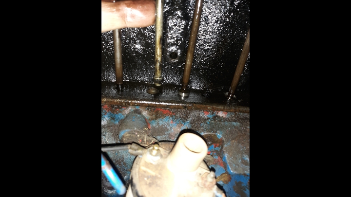

I have asked other questions about this tractor in tractor talk but the info I need now is more tractor specific.
It had a stuck valve. While working on it I discovered the rear oil line goes up and down when I crank it. I assume it is resting on a lifter? The front oil line was laying on the head and is a very loose fit. Any suggestions on how to fix them would be appreciated. I'm fixing it for a friend so I dont really want to buy a book.

My 4 cyl Fords have just one oil line to the rocker arms. I am pretty sure that it is towards the rear. They have a grommet that seals the tube to the hole. With time the grommet gets STUCK to the head, and you have to pull VERY HARD to get it out. Often the grommet stays in the hole. Since it is sitting on the lifter it must be in too deep. I would try a short piece of tubing like fuel line to reseal it. The front one is probably just a wish since whoever did it knew that the way he was leaving it wasn't right.

Am wandering if the oil line is loose in the hole, missing the little seal(EAA 6594A), and thus when the rotating cam , having a hole in it to spurt a little oil up that tune(line) it makes the tub jump. The hole for the tube in the head should be between No2 and No3 cylinder. The short tub is probably the one off of the front mounting bracket, situated like the long tub is into back support.

Yes, agree as to oil squirt making it jump, the line is between lifters, not able to contact one.

The long tube #36 needs the grommet #37 and it needs to be pushed down into the block to seal. The short tube #44 just dumps the excess oil on top of the cylinder head. If the grommet is missing or not pushed down in the block far enough to seal it will bounce from the oil pressure. The tube does not contact a lifter. It is in line with the rotating bore of the block that supports the camshaft. The camshaft has a hole drilled there and as it rotates it supplies oil from the block oil galley through the tube and to the rocker arm assembly.

Thank you everyone for the replies. I did not think about the oil pressure moving it. I kind of had it running before I took the rocker cover off. It looked to have gotten oil up there. Now that the valve is unstuck I think I will see how it runs before I look into replacing seals.

It is getting oil to the rocker and I can hold the line down with my finger.
Looks like it couldn't move very far if the valve cover was on.

You need to make sure it has the rubber seal on the bottom of the long tube and it needs to be pushed down so that it seals in the block. The valve cover will not hold the tube down to have it seal in the block. If it has the old seal on it, that could have hardened so it won't push down into the block. Had a 640 that the PO had done a valve job and couldn't stop the valve train noise. Only problem was that the tube never got pushed down far enough to seat the seal.

I finaly pulled the side cover off. Does the rubber seal just stretch over the line and pushed into to block? I see there is a hold down on top of the rocker. The diagram also shows a bracket but I'm not sure where it goes. Number 35 I think. Also is there supposed to be something to hood the front line? This one just falls out. Anyone have a suggestion as where to get a new seal? Thank you. Still haven't got it to run right but that's a different thread and I thought I would work on this while I wait for parts.
