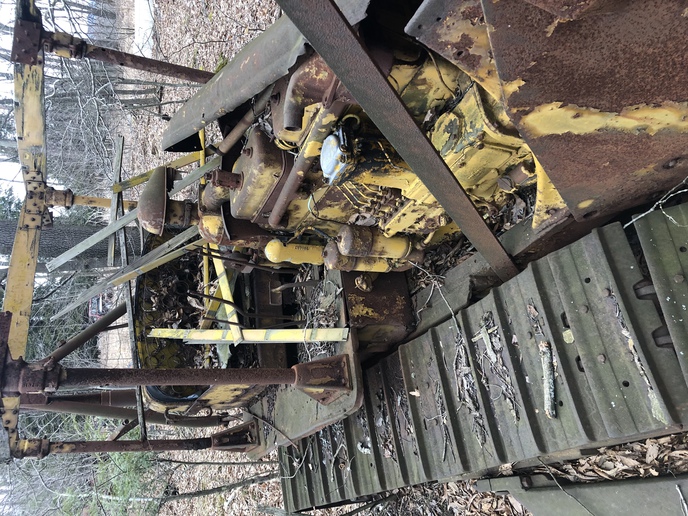

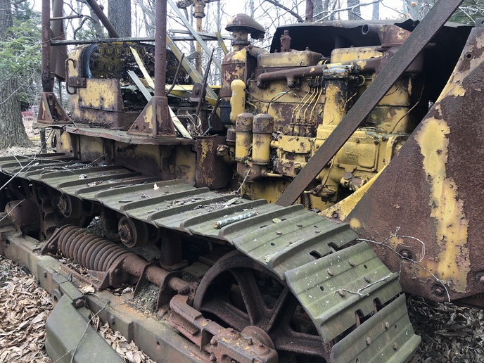

Central PA.. I was told this caught fire at one point and was parked. Can anyone tell from looking at this, offer opinions. We may be talking about being parked in 1960. Near as I can tell it is around 1941 d7. There is a video on YouTube of one and it looks identical to me. Thanks for any insight.

It could, don't get me wrong, you'll be investing quite a bit of time and money. It would take me a while to respond about the many things you'll want to look at on this tractor in the idle state it's been in for how many years.
1st thing you'll want to do is see if the engine is stuck, see if it turns over by moving the fan, if the belts are still intact. I'm not sure what that has for a clutch housing cover if it is a 7M series, and where in there you could get a bar on it to turn it over, you need to get to where the starting engine pinion engages it.
On the crankshaft pulley or end facing the radiator, there is a way to fit a steel rod with a dowel through it to mate up with the nut on it. Using a pipe wrench or if you have a hexagonal or flat surface machined in, a wrench may work with a big cheater bar, but if you need that cheater, it's stuck. I have been through that on one of these that looks similar, still have it and another in much better shape.
Look on the engine towards the back, and or on the back of the tractor, left side, above the final drive housing, see if you can find a serial number, if 1941, it's a 7M series, next series up would be 3T, and 4T which was a gov't purchase order of 10,000 units. There are some 6T's out there too, bought for the US Navy, and even more scarce are 1T's that were armored.
The starting engine needs to be checked out, see if seized. You'll want to really look over the undercarriage, at a glance it is well worn, but my oldest one is just as worn, your pads look better and I see what looks like a loose pad on yours. If it is worn out, I hate to say it, might want to pass. I like these old tractors and it's a nice thought to see someone bring one back, but can be a money pit, or you may luck out. I'd also want to make sure the heads are not cracked on the engine. These are notorious for sitting and being brought back, but if the engine is seized, you'll need to do some work to free it up at minimum.
The dozer kit is not LeTourneau, at least the radiator guard and front mast, + overhead ridge beam for the power control unit, (cable winch - these are not towing winches either).
Hopefully it does not end up as scrap, they are a handy tractor even today if operational. There are more things to check, want to make sure the sprockets are tight to the shaft, and that the final drives are good, minus the seals, those may leak a little by now, the bellows seals in these.
I'm all for going for it, but realize that is a lot easier said than done LOL !
I can refer to my manuals if you do need help , but you'll want yourself a set of those for this tractor if you decide to embark on it. Serviceman's reference book, parts catalog, and operators instructions + whatever may be available for the power control unit, (cable winch for the blade)

Thank you for the response. I looked in the front of the engine for just a moment the other day and I remember seeing slots on the front of the crankshaft where a bar could be inserted and turned. I don t remember seeing any belts, but I need to go back and take some more photos. This is sentimental to some extent, I am 37 now and I have played on it my entire life. I remember when I was a kid the slats over the roof were in much better shape. I probably slid the hood off who knows when.... I will get better pictures when I can as it s parked near my parents house. I live about 30 minutes from it, but it s out of the way of my normal drive. I really appreciate your response. Thank you.

Anything to help, there are some resources out there like the antique caterpillar machinery owners club and similar, you can find parts for these and so on.
I would reset that hood and make sure the exhaust stack is covered, looks like it is now. On the right side, there is, towards the front, lower of the engine an hour meter, just flip up the cover if you are curious to see the hours on it. I don't see much evidence from what can be seen it caught fire, but I can't see the left side of the engine. There is a small gasoline fuel tank for the starting engine, unless it was converted to direct electric start.
These are considered pretty durable, well built machines, they have a dry type clutch, later ones had an oil bath type which last a lot longer, but both were of the "bullet proof" kind of reputation. I did see olive drab paint under the yellow, on the injector lines, no doubt it is likely a military or gov't purchased tractor. If that diesel is not seized up, you've got a good chance with a lot of up front work to see it will run. I would be checking this thing over thoroughly, hopefully no one vandalized it. The books on it will be very helpful.
You'll want to check out the fuel tanks, drain out water, starting engine fuel tanks often get a build up of coffee grind size rust and plug the carb screen, these like good fuel supply and hot spark, the magneto needs to be in good shape to fire that engine. Carb is easy to clean on these, old cast iron Zenith carburetor. This tractor holds lots of oil in various compartments, you'll likely have a lot of condensation water to contend with. Coolant system also holds quite a bit, hopefully nothing froze up in the water jackets and cracked those heads, that can happen on these and the heads might be not so easy to find today.

It may have been mentioned already but I did not see any comments below about tracks.
That vintage of track link pins were not sealed and are very susceptible to serious rust seizure from setting for a long time. If so, it may not roll sufficiently to get it winched onto a truck. It might be costly to get the pins freed up.
Even so, I hope someone will take on the project of bringing your sentimental D7 back to life. We have an old D7 (3T?) in our family with the cable lift that still runs but rarely used.

If the engine and pony motor are not seized and the transmission and clutch housing are not full of water and frozen and cracked the housing, you have a good chance of getting it going. If you can get a good size machine or a couple of big tractors , you can tug it and maybe free up the tracks. I freed one up that had been sitting 30 years, tugged it with 2 good sized tractors, a little bit one way then a little the other way until it moved a track length Hopefully you have a cap on the fuel tank . that would save a lot of work, if there is a cap and fuel in the tank, you might have to treat the tank with biocide, but there are a lot of other things to consider before than. I have a 1944 4t D7 that runs and operates that I need to sell, located in MA.

If the crankshaft will turn any amount, I would suggest you don't turn it more that than a small amount about 5 degrees before you remove the valve covers and check for stuck valves. this might prevent the push rods or rocker arms from getting bent or busted.
Will the owner allow you to work on it where it is? If you have to buy it first, would you soon have to move it? I would think there would not be a problem with checking if the engine is stuck.
I think the track shoes are probably good enough to play with--- unless you want to work it hard.

Can't really tell from the pictures but it appears the radiator, fan and water pump are missing. If so, replacing those will add to the repair cost. Others have posted good points to consider.
Yes, it would be nice to bring it back to life. But think hard on undertaking this one, set the sentiment aside. It really won't be worth much, if any, more than now if you get part way through it and decide you can't finish. The money and time you put into it will be gone.
