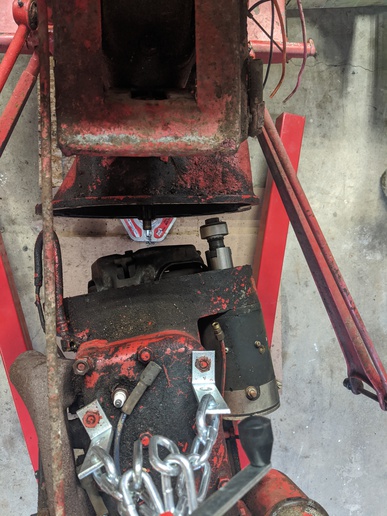

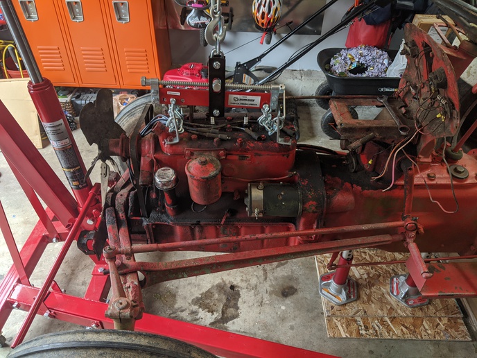

Looking to learn from this crowd. Already been in touch with Old Hokie, seems he is a little drive up the road from me.
Birthday gift. COVID 19 quarantine solution to boredom. Goal is to rehabilitate. This won't be a show tractor. I have a goal to parade the kids around for Halloween.
Photos above are just a few if many. This is three days work. I want to tear down the engine, send it off for a machine shop once over.
Get it running right. Brakes good, tires fair.

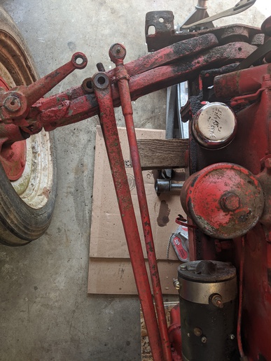

Need to tighten up steering. Seems I will start with TREs. Anything else to do with the front axle?
Ultimately, may move it to property in VA. Perhaps around the yard workhorse: brushog, around the property people mover, drag/haul things.
I am open to all wisdom here. Please. I have read the 75 tips a few times. Have a digital copy of the service manual. I am watching YT videos. I really get a lot out of videos posted by Jason in PA. Long videos with the process if restoring a '45 2N.

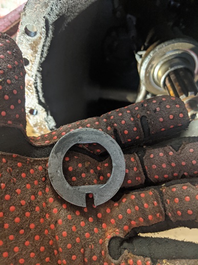

Anyone identify that last picture? It was sitting in the back of the bell housing.

Looks like part of an old starter bendix

PostPosted: Mon Mar 23, 2020 4:59 am    Post subject: Re: Rehab of a Fordson 9N (SN 9N13647) Reply to specific post Reply with quote
Thank you. I don't have the parts manual yet.. I see it would be of good use.
It seems the starter has been rebuilt or replaced. Metric bolts. So it would be a piece for it?

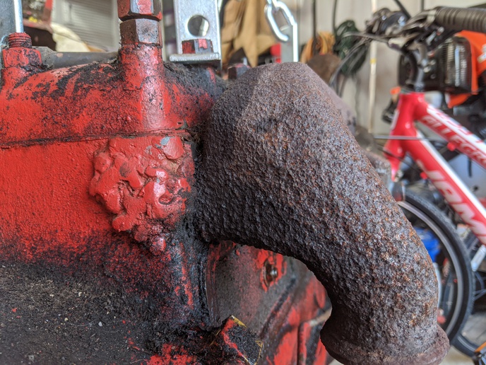

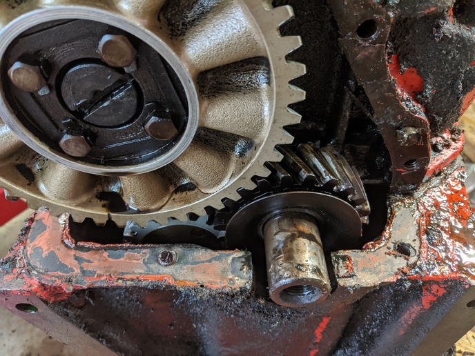

Anyone familiar with Mark Small machine shop in Westminster, Maryland?
I may be dropping the motor off to him.
Took heads, taller cover and manifold off for a peak. All the further I will go. I want them to do the rest.
A piece of metal in the pan.
Homebrew oil pick up tube. Cooper and some brazing of much better quality than the welding at the head.

PostPosted: Wed Mar 25, 2020 4:40 am    Post subject: Re: Rehab of a Fordson 9N (SN 9N13647) Reply to specific post Reply with quote
I would replace the block...
Back to top
View user's profile
FrankOceanXray
Regular
Joined: 19 Mar 2020
Posts: 69
Report to Moderator
PostPosted: Wed Mar 25, 2020 5:48 am    Post subject: Re: Rehab of a Fordson 9N (SN 9N13647) Reply to specific post Reply with quote
Got one for me?
And based on the welded corner?

grhuck
Regular
Joined: 25 Apr 2018
Posts: 31
Report to Moderator
PostPosted: Wed Mar 25, 2020 8:37 am    Post subject: Re: Rehab of a Fordson 9N (SN 9N13647) Reply to specific post Reply with quote
FrankOceanXray wrote:
(quoted from post at 02:51:00 03/23/20)
Thanks.
I split my 8N 2 springs ago for a new clutch et al. A washer identicle to the one in your photo was laying in the bottom of my bell housing as well.
That is a washer from a starter Bendix drive that failed.
