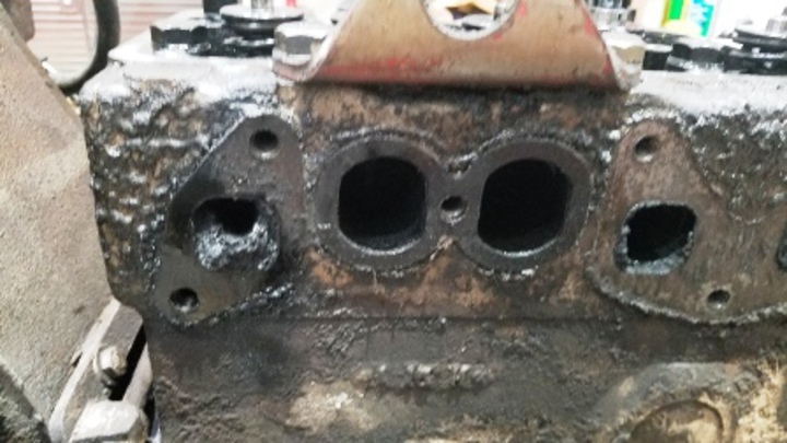

Hey everyone, I have been lurking around these pages for a while and reading all I can.
I picked up a 59 Ferguson Diesel Deluxe this past sat. SN Sdm191471
I intend to use it to run a finish mower on my property (we moved to Harrisonburg VA) this past October.
I ll get more pictures. But it looks like they plugged the glow plug holes on all but one, which is welded after stripping the threads. Previous owner says it has new pistons and sleeves. Rebuilt injection pump. They added an electric fuel pump for priming. It starts with ether, then hot starts with out it.
We bought a manual and plan to check the pump timing. When it first starts it sounds pretty rough. I can t tell if it s rod knock or not.
Video below is after it had been running. Smokes more than I would like. I m going to keep searching here but any initial impressions would be appreciated.
I also would like to find someone close by that knows these engines.
I want to put it to work soon but don t want to damage it (any further)
One pic is of my son and father.
-Brad

PostPosted: Mon Mar 23, 2020 3:45 pm    Post subject: Re: New to Me TO35 Diesel Reply to specific post Reply with quote
Welcome Brad!
Hard to tell listening to a diesel, especially if it's new to you and not familiar with what it normally sounds like.
One thing for sure, if it is a bearing knocking, it will soon show itself if that is what is knocking!
A shop manual is a wise move. Study it, get into the design, you'll find all kinds of neat things you didn't know were there.
A known good oil pressure gauge is a valuable tool. Check the hot idle oil pressure against the specs. If it's good, it is safe to run unless there are other symptoms like oil consumption, excess blow by, idle misfire, etc. Might run the valve clearance, good chance to clean out the fuel tank too.
Have you checked the trans/hyd/diff oil? They are known for collecting water. It gets in through bad shifter boots and the draft link boot under the seat.
Let us know! Glad to help!

PostPosted: Mon Mar 23, 2020 5:20 pm    Post subject: Re: New to Me TO35 Diesel Reply to specific post Reply with quote
CVPost-Steve@Advance wrote:
(quoted from post at 16:45:53 03/23/20) Welcome Brad!
Steve Thanks for the encouragement. Fuel tank looks pretty clean inside. Fluids look clean. It will be barn kept from here on out.
I did find the air filter pretty full of dirt so hopefully a new one helps the mixture/ not smoke as much. Ideally I find a new head to have ready to swap out over winter.
The oil pressure gauge on it reads. About 37 pounds but I ll get a good gauge on it. I ll monitor fluid consumption as well. I have my finish mower almost set up (used sitrex) so we ll light that off and see what happens.
I do also notice when the the lift arms are under load, even lifting me, they pulse as they go up/stop at a given point off the ground.

PostPosted: Tue Mar 24, 2020 11:16 am    Post subject: Re: New to Me TO35 Diesel Reply to specific post Reply with quote
This is a Standard diesel, not a Perkins, right?
If so, what I found on the oil pressure, 60PSI @ 1400RPM. There is an externally adjustable relief valve on the oil filter base. If you adjust it, be sure the engine is up to temperature and at 1400 RPM. Note where it is before turning it. If turning it in doesn't have an effect, return it to where it was.
Any engine will drop oil pressure at idle. As long as it has "some" pressure, it should be good. Typically the general rule is 10 PSI per 1000 RPM minimum, so 5 PSI at 500 RPM is safe. Scary, but safe, I'll let you make that call! LOL
As for the lift being jerky, that's a sign of a bad valve in the pump. A common problem with those. A rebuilt pump is the easiest solution. I tried rebuilding mine, the aftermarket parts were not right. Spent many hours fitting it together. Had I not had access to a lathe and surface grinder, it would not have been possible.
I would go ahead and cautiously run it, at least long enough to find all the problems. That way you can have a better idea what to spend and how far to take it. The last thing you want is to get it all back together only to find another problem and have to go back in!

PostPosted: Fri Mar 27, 2020 2:03 pm    Post subject: Re: New to Me TO35 Diesel Reply to specific post Reply with quote
Thanks for the replies everyone! I ll probably get another head this fall and swap out in the winter.
I didn t do the rebuild so no telling what they did. Glow plug holes are plugged. One is welded.
Which 12v glow plugs did you use and how are they wired? Are you on one battery?

PostPosted: Sat Mar 28, 2020 5:42 am    Post subject: Re: New to Me TO35 Diesel Reply to specific post Reply with quote
When I rebuilt the engine yes I cleaned the pre-combustion chambers, had too. Most of the exhaust ports and the exhaust manifold were all but plugged up with carbon. I replaced all the valves, they were badly carboned up as well.
I have one battery. The glow plugs are 12v wired in parallel now. I will have to find the literature for the glow plugs I'm using now. They are M14 x 1.25 threaded, I believe I used a gam 101 glow plugs by Britparts for Land Rover. I bought a number of different ones to try which I haven't tried since the 1st ones worked well.
More info http://www.soggers.ca/tractor/glow_plug_info/glow_plugs.html
Hard part for you will be finding a good head with glow plug ports. Some have taken none Glow Plug heads and machined them for glow plugs.
