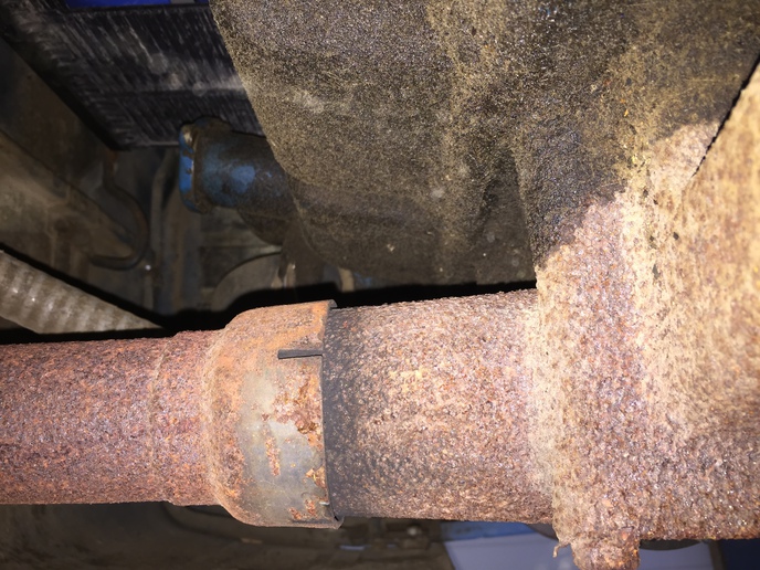

I need some info as to my exhaust pipe turning, can I put a band clamp on the pipe at the manifold or is that a bad idea. This is on a diesel engine.

Your engine uses different exhaust manifolds for horizontal and vertical exhaust applications.

Mine does the same thing and has no clamp. The short pipe from the casting up to the muffler is clamped at the muffler but not at the cast iron manifold.
At least, like this, we can run into low roofs and tree branches and not risk cracking any cast iron.

The verticle exhaust comes with a short pipe that is made to sit in the exhaust maniford, with a "flange" on it to keep rain water from running down into the manifold, AND.. the short pipe is reduced at the top to allow a muffler to sit over it. It is designed so you DONT have to use a clamp... AND its designed so you can simply side the muffler off when you need to pull the hood. This short section is availible from many aftermarket companies and is very inexpensive.
https://www.yesterdaystractors.com/Ford-3000_Pipe_D0NN5B255D.html
just over 15 bucks but worth every penny. Hope this helps.

I'm assuming you have a oval muffler and don't like it turning sideways?
You can put a clamp on the pipe but don't tighten it to much or you'll have problems getting it back off at a later date, also there's a short extension pipe that fits to the exhaust manifold and the muffler fits over that extension. The manifold has a notch and the extension pipe has a dimple that fits into that notch, this keeps the extension pipe from rotating, sometimes these don't fit together well or the dimple wears out allowing the pipe to turn, if this become as issue replace the extension rather than trying to clamp it to the manifold.
The pipes are worn on some of my tractors allowing the muffler to turn, but I run the round mufflers so it's not a issue.

The muffler is round but it was bent from hitting something before I got it. I don't like things turning and moving around, I think I'll replace the manifold pipe and muffler. I'll put a band clamp on just to keep the muffler a little more solid and keep it from turning.

I have a 3000 and 3910, both with vertical exhausts, one round muffler and one long and oval. Both have muffler clamps like found on an auto's exhaust....back in the old days.
