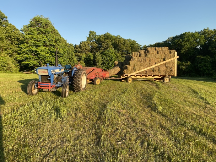

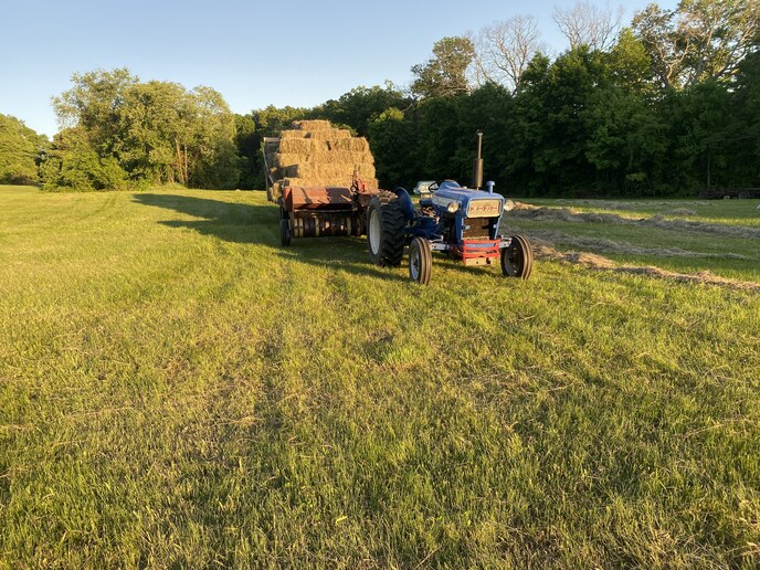

I don't know what kind of grasses that are in there, but the bales came out good, there were a few that were heavy, but a lot better than the first time we tried to bale and dryer than other people's hay. We flipped the hay over Thursday. We ended up baling our field last Friday last afternoon, Saturday afternoon and Sunday afternoon. The bales didn't turn out so bad. The bales are going to be for the cows and goats. There are no 70 pound wet bricks in there.

We raked the rows once before it rained, then let the top of the rows dry for a few days and then Flipped the rows to dry the bottom then baled a day later depending on what row was dry enough. We got 200 bales off a 7 acre field.
