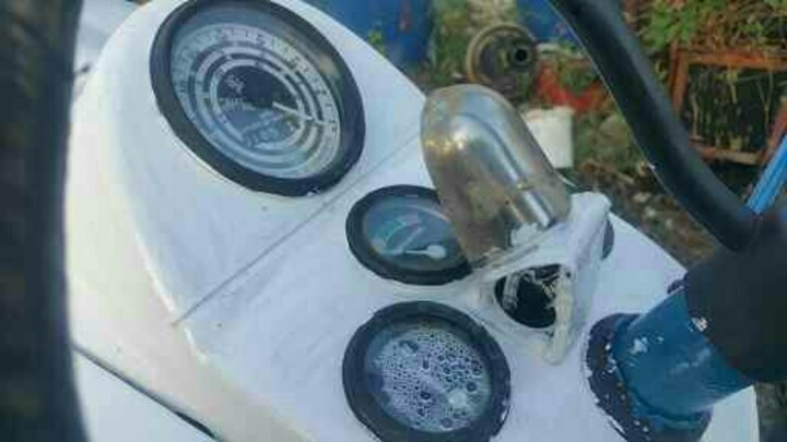

Restoring a 66 year old tractor can be a challenge. I just about cleaned TS out of fine thread bolts, not to mention left hand drill bits and easy outs to remove the broken studs. A very good day when it was completed. Just gave it another face lift to address sheet metal rusting, but used left over paint from 4000 restore. Red/Gray was out of budget for now. Can always repaint later.
