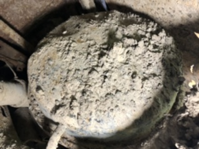

Hi All
I am trying to figure out why the vacuum brake booster no longer works on this 1977 GMC 6500. Ive followed the vacuum line to the vacuum booster under the cab to this valve as I call it under the slave cylinder. The slave cylinder is bolted to 2 vacuum pots as I call them. I have yet to crack any of the rusted lines. We have bled the master cylinder and slave cylinder yet the vacuum assist function appears to be not working. I have taken lots of photos. Ive attached a few.

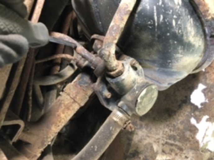

Figured out how to load photos in a smaller size. One photo is of the double vacuum boosters. The other photo shows the slave cylinder attached to rear vacuum booster. I was wondering if the valve below slave cylinder is a valve that can fail. Im hesitant to start taking removing lines from valve or the square plug from booster. We oxy\acet for hear and propane. If there is vacuum coming to this vacuum booster set-up where does a person start and end to check if the boosters are working?

Heres the valve. Ignore the receipt

What is this vacuum booster set-up called?

Well finally put truck in shop. I was wondering with truck running the vacuum gauge thats mounted in dash reads 15 psi. Vacuum drops to zero when I hit brake pedal. When foot comes off the brake pedal the vacuum comes back up to 15 psi. My thinking is that vacuum should stay at 15 psi regardless if your pressing brake pedal. Am I right?
We took pipe plug out of front of most forward brake booster. Buddy put his thumb over hole as I started truck and he could feel lots of vacuum. Again if I pressed brake pedal, buddy said he would not feel any vaccum. The forward section of both boosters where the vacuum lines attach should be sealed units and vacuum should constantly stay close to 15 psi even when pedal is pressed. Am I right?
Also I feel pedal drop slightly as I start engine. However as engibe runs and I push pedal a few times it feels hard, unlije the first time when I started truck with brake pedal slightly pressed.
I found out the truck uses the Cardone 51-8009 brake booster set up.

The pedal dropping slightly on start-up is normal. The system is definitely loosing the vacuum when the pedal is applied due to a leak somewhere. The quest is - at which point. Any and every point from supply to application is "suspect". Trouble shooting is sometimes very tedious... there is a rat hiding somewhere. Thanks for keeping us posted.
