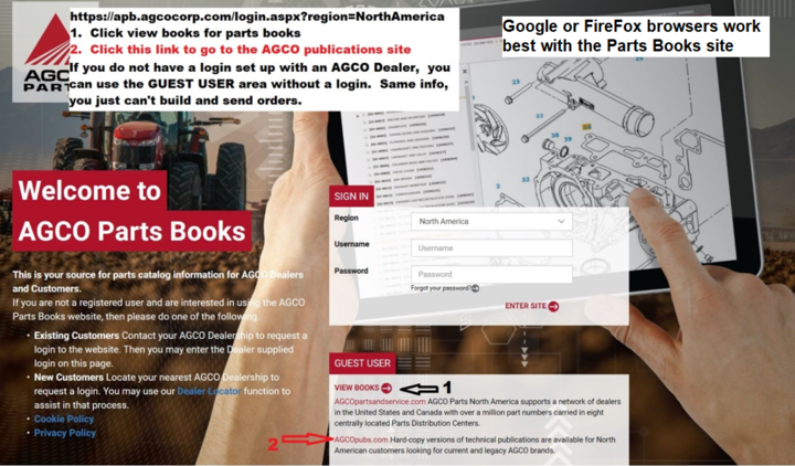

Is this tractor new to you? I would recommend you get a set of manuals (Operator's and Service for sure, Parts optional) for it. You should be able to find good used OEM manuals on eBay, they are usually better quality than most of the new reprints. AGCOpubs.com is where new Allis Chalmers manuals are sold. If I remember right series 1through 3 are pretty much the same and use the same manuals. Series 4 had most if not all three manuals of its own due to changes made for Series 4.
Here is a link that will get you to the AGCO on line parts books and it has a link to the publications site.
https://apb.agcocorp.com/
