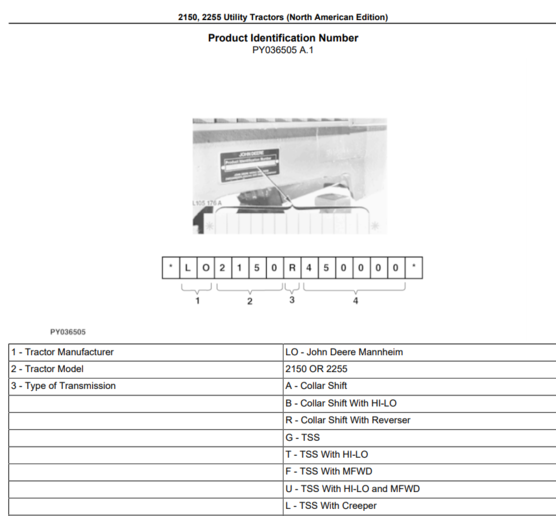

Does your tractor has CS or TSS type trans? Letter on VIN tag will reveal type of trans

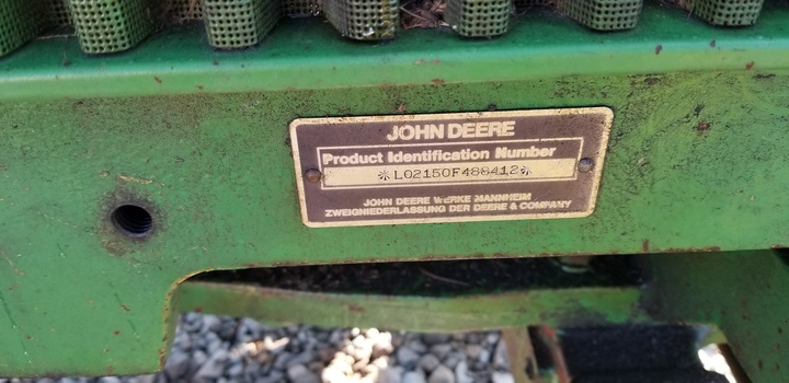

PostPosted: Fri Jun 26, 2020 4:40 am    Post subject: Re: John Deere 2150 Hi-Low question Reply to specific post Reply with quote
Here is the VIN

PostPosted: Fri Jun 26, 2020 6:35 am    Post subject: Re: John Deere 2150 Hi-Low question Reply to specific post Reply with quote
"F" indicates your tractor has TSS with MFWD.
My guess is clutch is warped,pilot brg is rusty or trans synchronizer's are faulty.

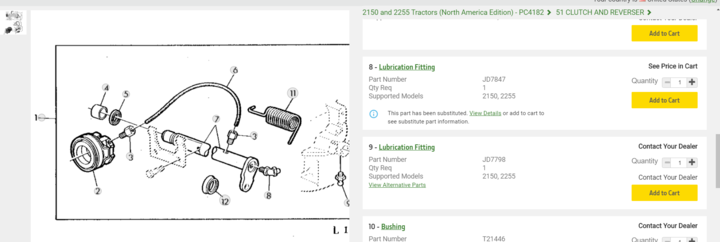

iirc there is a grease fitting for the clutch throw out bearing and slide . Your operators manual shows where and how in a picture .

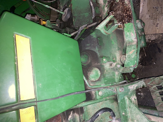

PostPosted: Sat Jun 27, 2020 5:26 pm    Post subject: Re: John Deere 2150 Hi-Low question Reply to specific post Reply with quote
If this works, this is a pic of my 2550. Throwout bearing zert is behind the round plate on the left. Under the door to the battery. The plate just slides out of the way.

PostPosted: Sat Jun 27, 2020 5:27 pm    Post subject: Re: John Deere 2150 Hi-Low question Reply to specific post Reply with quote
Sorry, no idea why the pic is sideways or how to fix it.

Not all 2150 models had a grease fitting on throw-out brg.
JD offered a kit(AL39931 @ $767) to add grease fittings to some models.
