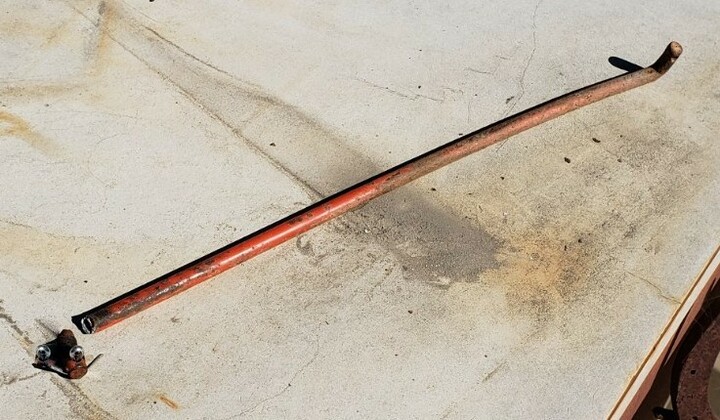

Hi there,
I am looking to find a replacement clutch pedal rod for our 1956 Case 310B. If anyone has a good source, I'd love to hear from you. I've got calls into a couple different part houses, so I'm hoping something turns up.
Absent finding a replacement (part G10748) one potential option is trying to fabricate a new one. Unfortunately, I don't know the specs for the part (length, rod thickness, length of 90 degree ends). If anyone has the ability to provide those numbers that would be greatly appreciated.
I realize that welding our current (broken) part could be an option, but it appears that a small segment may have broken out, so I'd still be unsure of the length.
I apologize for a post with little detail. I'm having a hard time getting past YT's filters - they doesn't like some of the words I'm using.
Thanks in advance.

Hi Joe, thank you very much for the information. I'll be sure to reach out to those two gentlemen to see if they can help.
I appreciate the additional information about the clutch rod, but I'm actually looking for the clutch pedal rod which is a different part. I didn't mean to cause any confusion - I just went with the name that is in the Case service manual.
Since the clutch rod is 5/16", I'll go out on a limb and guess the clutch pedal rod is the same thickness. So, I'm 2/3rds of the way there with measurements.
The part I'm looking for in your black and white photo is the straight piece that is adjacent to, and just below, the return spring. On that drawing, the rod is not labeled.
I'm sorry I have to describe it to you, but there is something going on with photos when I try to post them. I get an error message that there are words or characters in my post where the system believes I am a bot or a spammer.
I have the drawing marked up, but I don't know what's going on. I can "preview" my post with the photos, but I can't "submit" my post without receiving the error message.
I'll keep trying.
In the meantime, thank you again for your assistance.

I think I found a way to add the photos from the classic view side of the house.
One photo is the part I'm looking for on the diagram that Joe sent, and the other is the actual part from another site. Hope these help to clarify.
Back to top

I should have looked up your p/n before posting. Anyway no harm done. The part is generally referred to as a link but it is part of the clutch rod arrangement.
These are some of the tractor models that have that part in case you have to do a salvage yard hunt.
G10748 LINK Case parts 600B-SERIES, 630, 430CK, 470, 300B-SERIES, 320, 430, 400B-SERIES, 320B, 420B, 420BD, 530, 530CK, 300-SERIES, 500B-SERIES, 570 LINK
Your tractor is one of the models in the 300B series, 310B is a utility tractor that only built in 1958 & 1959. If the model/serial tag still exist post the serial nr so we know which year it was built as some parts change by serial nr. If the tag is missing post a pic of the steering wheel and I will be know the build year.
Don't assume that the part is 5/16", I will check in the AM and post back if it is other than 5/16".

Well, I thought I'd come back and provide a brief update:
After a small hiatus from dealing with the tractor, today we finally got a chance to install the replacement clutch pedal rod that we received. After a bit of tinkering and getting it installed, the wife hopped on the tractor to depress the clutch and test what we'd done. Upon doing so, "SNAP!" The just-installed rod broke in the exact same spot as the old one. Right at the 90 degree bend that goes into the linkage where the clutch rod ties in.
Fortunately, in my part search, I'd actually gotten two, so the second one was installed. I'll keep it short...things went well and the test drive of the tractor was fine.
So, at this point in time, it looks like things are okay...so far. Not having a back up part, I'll be contacting Jean Claude who let me know earlier in the thread that he had some.
Here's a photo of where the break was on our most recent rod. Was this a weak link on the tractor? The wife, who spends most of the time driving it hasn't noticed it being excessively hard to depress the clutch pedal. Or, is this just bad luck?
Thanks again.

PostPosted: Wed Jul 15, 2020 7:36 pm    Post subject: Re: Case 310B Clutch Pedal Rod Reply to specific post Reply with quote
I've had a 1959 311B & a 1956 310 for about the last 20 years, they both have that rod. The 310 spent most of its known life
doing loader work on a dairy farm, notably scooping manure in the barn an adjacent areas. They both have done a lot of loader
work since I have had them also putting a home site in a heavily wood 6 acres so the clutches got a workout. I have had to
replace worn down clutch friction disc on both, also replaced pressure plate & release bearing while they were split so they
clutch operating linkage has been worked. No signs of the rod fracture you have.
I have the linkage well adjusted as per that diagram I posted. I suggest you do the same if you haven't already done so.
Breakage like that would appear to be from a twist as the clutch pedal is pushed down, something to eyeball.

Thanks Joe. We've roughly eyeballed the linkage, and it hangs somewhat the same as it is in the diagram. Free play is about 1 1/2".
I'll take a photo of that linkage piece on our tractor. It actually has a slight twist to it where the rod inserts, and I was left wondering if that is normal. I don't know how to describe it, so I'll grab a photo the next time I'm out there. Thanks again for your help.
Dave
