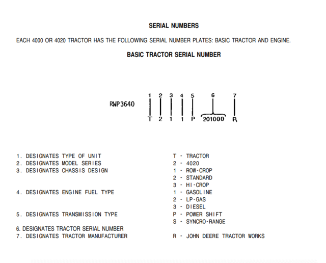

Looking to get this tractor next week, trying to decode this VIN.
T213R 201454R

Earlier model 4020 <sn 200,999 show letter designation as R - SYNCRO-RANGE not "S"

I think all syncros were "R", and that the chart is incorrect??? I've never seen one with an "S".

I agree that the "S" is probably incorrect BUT JD needs to correct the mistake because it's in their parts catalog.
