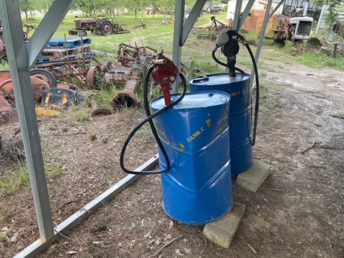

Has anyone ever had this happen to them? I just got these new used barrels (had motor oil in them) and installed a brand new Fill-rite FR-112 rotary pump. I cracked the small vent plug on the drum but I guess that wasnt enough? You can see the other drum there and its our old pump on it. That pump was installed on an old drum we have and had it for about 30 years with no issues like that. I dont like keeping that vent open in fear of getting trash and water in. Do you think these drums are made with thinner material now?? What would be a good solution so this doesnt happen again? I can get another drum.

Make a 180 breather stand pipe in place of the vent plug. A 3/4" NPT x 4" nipple, 3/4 street elbow, 3/4 elbow, and a 3/4 NPT sintered bronze breather vent (180 allows it to be pointed down).

Yes I was thinking of doing an elbow vent out of pipe. Didnt know how to keep bugs and trash out though. Thought about some type of check valve type thing

Natural gas company has a yard near the house. During the Summer the drums of different chemicals does that. At night you can hear the drums contracting and all during the day they expand.
If the vent plug has a flat bottom. You can drill them and install a valve stem. Remove the core. Place a piece of fuel tube long enough to hang over the edge of the drum and then install a small engine inline fuel filter on the end of the hose. It allows the drum to vent and the filter keeps dirt and water from entering.

The do vary in strength.
16, 18, 20, 22ga
No ribs, two ribs, three ribs
About a dozen different UN ratings one of which is test pressures ranging from 100 to 300 psi.
I guess you now know your pump is not worn out.

Bush the vent hole down to 1/2 NPT, put a nipple in it and find a small oil filter with 1/2 NPT threads.

sintered bronze breather fitting pointing down will do it.

Didn't the pump get hard to turn?

Marine Fuel tank vents come in a vast variety of configurations, some are surge proof and restrict fuel from getting out, but vent inward, as well as
keeping liquid (water) from getting in when placed above the barrel rim. All have screens that are approved for flash suppression. Cheap as well. A
barbed hose fitting a 2" piece of quality neoprene hose, and the boat vent. My suggestion. I googled - Marine fuel tank vent. Jim

Remove the pump. Install a tire valve right beside the opening to the drum, you'll have to drill a hole. Put air to the drum untill it pops
back in shape. Then as other s have said vent it with a 90* + 90* so no water can enter.

Impressive what 14 psi will do. Yes drums are thinner today. .
We get metal delivered in them and some of the drums are so thin they collapse when we pick them up from the outside
with a forklift and barrel lifter.
