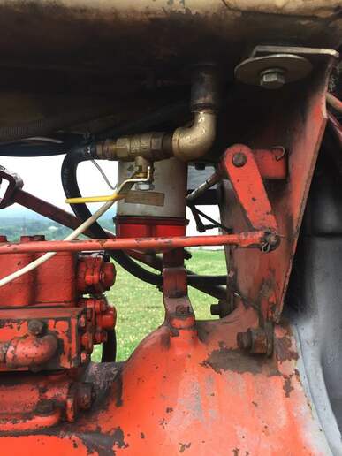

I need a fuel shut off valve, the one on the bottom of the fuel tank. mine is damaged and can't be rebuilt. Any ideas on an aftermarket valve or does anybody have a good used one. 1965 Case 430 diesel with 188 engine

I have a 530 with the original single filter body under the tank, that gave me trouble so I went to the hardware store and picked up a 3/8 th inch 1/4 turn brass ball valve and hardware to screw into where the present drain goes and hardware to get down to the line size at the filter line, Lots more volume since 3/8 comes out of the bottom, if you wanted to have a drain you could use a Tee out of the tank and put a valve on the bottom. I will try to add a pic in another note.

Well my 530 has a radiator type valve on bottom
of tank , but that’s to drain off the water that collects in the diesel
fuel , Then there is the fuel line and it’s shut off also
connected to the tank higher up .

My 530 is the very earliets design with a single filter on the tank bottom, I will send a pic if all goes well, hang on!

Thanks for the picture. I think I found a good used one.
