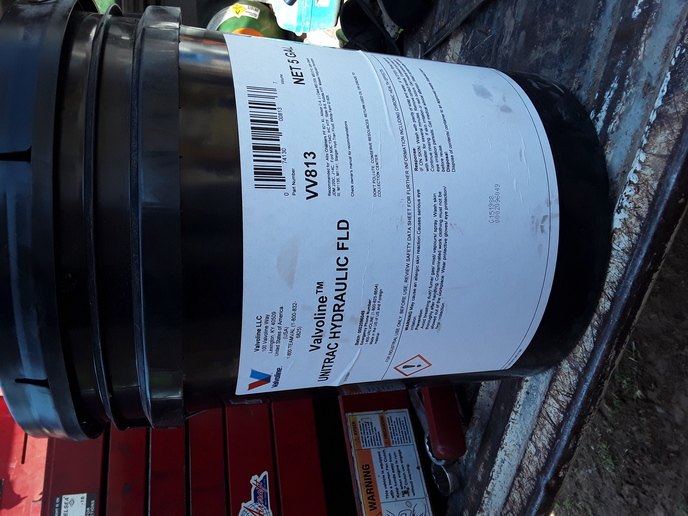

There are likely many opinions and techniques y'all have been using that work. I found one on the sciencing site but can't post the link
From what I found on Valvoline's web site and other online charts the VV813 (141 VI) has better lubrication than Mineral Oil at 0F and slightly better than Mineral Oil at 100F. For the transmission, differential and pump $70 per 5 gallons I thought it would be cost effective to test the newer oil. My tractors 600 hour intervals won't come every spring but maybe every third. Shifter boot is good, seat bolts are tight and I am building a shed soon. My only concern is condensation.
Other than cost what are your thoughts on VV813?

My answer is a question. Why are you comparing it to mineral oil? 90w mineral oil as well as 50W motor oil were both approved substitutes for wartime use only (WWII) a time when obtaining any lube was near
impossible. I've been there done that substitution, trying to get gas to do the spring planting was extremly tough too. No need to re-invent the wheel, GL-2, GL-4, GL-5 as well as 134 hydro oil are all fine.
Here in the warm sunny south 134 is not the favorite but it is very practical and truly loved in the northern frigid regions.

Why all of that to address a problem solved years ago by UTF?
No need to get the expensive stuff; TSC UTF is fine.
Sheds, shifter boots, etc will not prevent the #1 cause of water in the hydraulic fluid: condensation. Unlike engine oil, the pump, transmission and differential
rarely get hot enough to burn off the naturally occurring condensation in 5 gallons of fluid.

It is a generic UDT with the same physical properties as Ford M2C-134D, Kubota UDT, JD J20C, and litany of others. In an N-series tractor it will be indistinguishable from TSC Traveller premium UDT which is half the cost. I'll save the $35:per pail and spend it on beer and golf.

That compatibility information is usually located on the label as pictured above. As for being the same and unrecognisable there is more to it. The properties can be found on there website and then compared with the UTF and others mentioned. That is up to the user, I am satisfied with my choice.

I have looked at dozens of product data sheets over the last decade or so and I can assure you there is little difference in the physical and performance properties of most premium UTF's. Here is what you will find:
Kinematic viscosity @100C: 9.4 to 10 cSt
Kinematic viscosity @40C: 55 to 60 cSt
Viscosity index: 135 to 140
API service classification: GL4
API viscosity grade (gear oil): SAE 80
API viscosity grade (engine oil): SAE 10W30
Valvoline VV813 is a fine major brand name UTF but at twice the cost of a premium generic. In a modern tractor with wet clutches and brakes or hydrostatic transmission VV813 MAY have a small discernible performance edge but not in a 70 year old design like an N-series. I have no quarrel with your choice but you asked for science and I have given you some.
