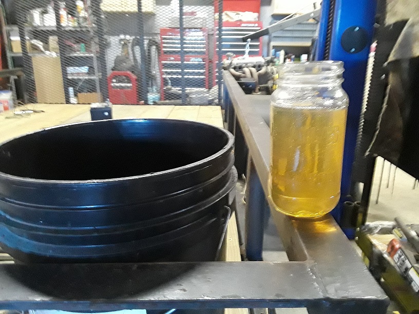

1941 Ford 9n - I don't know how long it has been since the engine oil and hydro oil was last changed, my brother-in-laws uncle passed away two years ago that took care of the tractor...
As I was removing the first of three plugs to drain the hydro oil I had water start to run out. I estimate about an ounce or two of water drained out before it started turning milky. Once it turned milky I tightened the plug up and dumped the water from the pan and then started draining the rest of the hydro fluid which was milky then black... I have not pulled the other two plugs yet. I don't know how long the water has been in the hydro oil. The tractor was last ran last weekend mowing around their little ranch. What should be the best plan of action? Should I try flushing the transmission/pto system with kerosene and diesel to clean out any remaining water and then refill with appropriate hydro oil or am I looking at a total tear down to clean it up?
<img src="/cvphotos/cvphoto56363.jpg">
I've seen worse looking transmission fluid. If the tractor was running, shifting ok and the hydraulics worked with no undue noises I'd pull the other 2 plugs to drain as much fluid as I could, reinstall the plugs and pour some kerosene or D2 in till ti shows full on the dipstick, let her sit for a day or 2 and drian it back out, run a magnet around inside your drain pan to see if it picks any metal. It that doesn't show anything too alarming refill with 90W Hytran and see what happens.
Worst case scenario is that the water froze and broke something but you'll know that soon enough with an oil change and test drive.

Have you ever dropped the pump and really cleaned it out? It might be time to do it.
Flushing it out doesn't get rid of the hard-packed crud in the pump base.
See tips 3 & 4 re re-filling it.
If you operate the tractor below 32* F, you will be much happier w/ UTF instead of 90w.

Drain all three plugs and let it set to get all you an out. refill with UTF and use it.

lw, your oil situation is perfectly normal for the 9N under the conditions under which most of them are used these days. Do you ever get humid air where the moisture condenses on metal surfaces? If you do, when the moisture is condensing on the outside of the tractors housings it is also condensing on the inside. When the N was in daily use and working it didn't take long for the temperature of the oil to get high enough to drive the moisture out. If it runs for just a few minutes under light load moisture will build up. The oil that they used in them 70 years ago didn't absorb moisture. If it did accumulate during quiet times it stayed on the bottom of the cases where it could be drained out periodically just as you did. The additives in modern UTF, which your tractor probably has in it, absorb moisture much more readily than the oil originally used. You need not worry about flushing the oil out. Most Ns in use today have moisture laden UTF in them because more modern is always better right? If you will be using the N hard enough to get it hot for two hours every other month, that is all you need to do. Otherwise plan on changing it at least twice a year, or go back to the original 80-90 oil and just drain the moisture off the bottom every six months.
Chocolate milk in the sump is not normal or desirable and ou have this absorbtion idea backwards. You want the oil to absorb condensation rather than allowing it to remain free. When absorbed the water is INVISIBLE.and HARMLESS e.g. - no chocolate milk. The gear oil in the picture has visible free water in it. The condensation has not been absorbed and instead has formed a chocolate milk emulsion. This emulsion and free water inhibits lubrication, promotes rust, poses a freezing hazard, and is bad for gears and hydraulics.
Water management engineering was pioneered by John Deere in their HyGard UTTO at least a decade ago and has become an industry standard performance metric for UTTO. Here is how Case engineering explains it with regard to their HyTran replacement for the old Ford M2C-134 hydraulic/transmission oil. You will find similar explanations and products from other major tractor OEMs.
HY-TRAN ULTRA UTTO (MS1209) HYDRAULIC/TRANSMISSION FLUIDS FOR CASE, INTERNATIONAL HARVESTER & CASE IH EQUIPMENT
Case IH Hy-Tran Ultra will absorb at least 1% water and still remain stable as demonstrated by the Case MT-805 Water Tolerance Test.
Case IH Engineering has determined that it is essential to have moisture (primarily from condensation in service) absorbed without causing additive or water separation.
Free water can promote rusting and can accumulate in low spots and freeze, resulting in restricted flow and pump cavitation.
