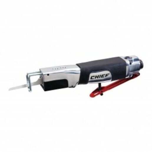

I might give one of these body saws a try... Smaller reciprocating saw that the big bulky sawzall...

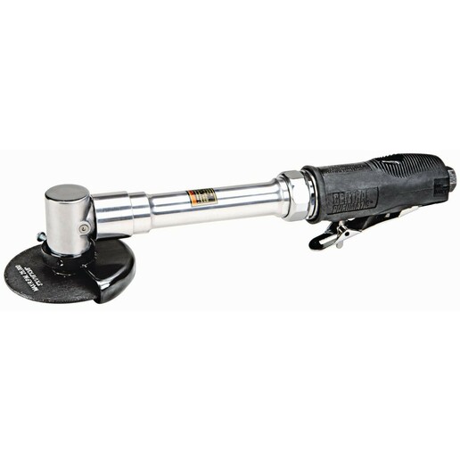

Forgot about extended reach air driven cutoff tools.. I picked up a cheap one at Harbor Freight with the 3 inch wheel.. I figured a 4 inch wouldn't fit and I was right.. The 3 inch gave me just enough room to work with it.. I laid over the back of the tractor (top cover is off) and put the cutoff tool in from the right side (dipstick) inspection port (I am right handed).. It took me about an hour and a half to get through it but it only used up about half of the first wheel. The 3 inch Harbor Freight tool was a little under powered so that was one reason it was slow going.. Just had to keep patient and work with it. I have a big 80 gallon twin cylinder compressor and it had to cycle quite a number of times..

Thought I would follow up with a pic of the extended cutoff tool I used in case anyone needs to have a visual... As I mentioned above, it works pretty good but is a bit slow....
