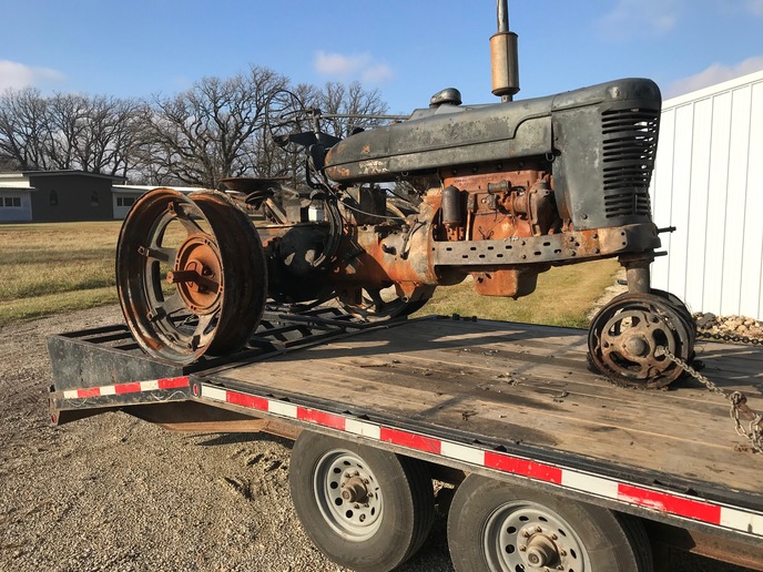

I picked up a couple tractors that are Crispy Critters. I wanted the 350U for the steering box and fast hitch and I was going to pass on the M and let the scrappers have it. I then found the little lever on the right side, and, well - I found room on the trailer. Hopefully I can get some good parts.

The M must have been really HOT, the right side frame rail looks bowed. Mufflers look good though!

They both look bent, so it's got a 9 speed transmission you figure, Charlie,it must be a Heisler ?

On the right, makes it an M & W. Hiesler is on the left.

How were the smores? Must have taken some heat to bend the M.

Could lever be a hydraulic pump disconnect, my M has a nine speed and a disconnect for hydraulic pump.

Was wonder also about the frame on that M. Looks interesting, but I'll pass, hope you make out with this project, and if
you can get them both to a show that would be something to brag about. Keep us up to date.

If the oil is burnt out of the M tranny, the hears may have been taken above the lower critical temperature then cooled slowly. If so they will be
annealed to un-usability. The 350 steering box may have faired better, as there looks to be some red paint on/near that area. Best of luck Jim

I found these two tractors that went through a shed fire last spring north west of Mankato MN.
When I unloaded the M from the trailer I had oil leaking out of the PTO seal. It will be interesting to see what the gears look like once I get inside. These both are going to used for parts.
I did get the head pulled off of the 450 and it looks good to the eyeball. Might be a different story when it's cleaned up and checked with the mag.
I did notice that there are still pistons with an IH number readable on the tops.
